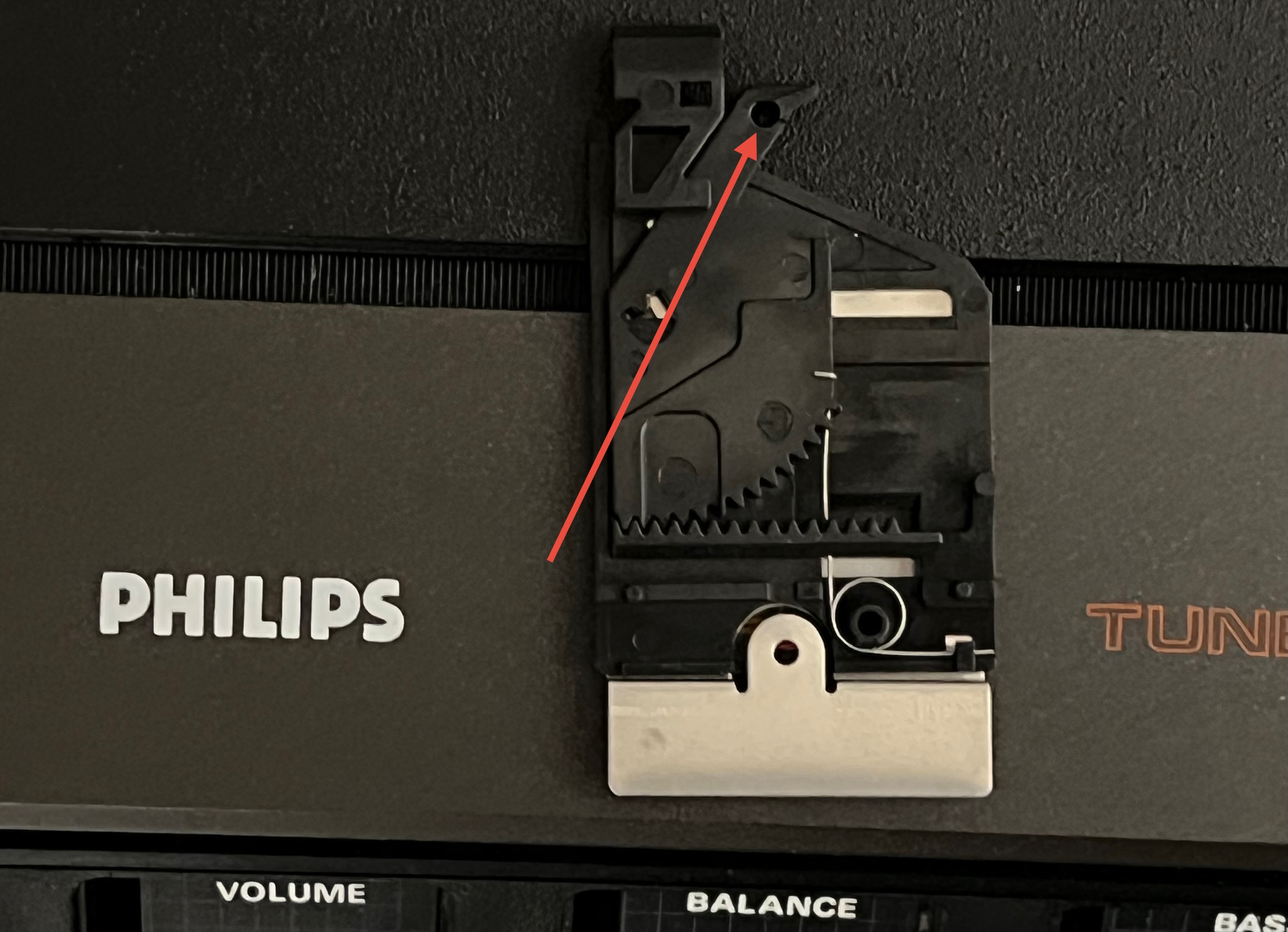

Maybe you putting de pinch rollers in the wrong position. It happen to me once. The tray cannot lower the cassette. You can test it manually.
Or a broken lever that is used to release the cassette slider.
