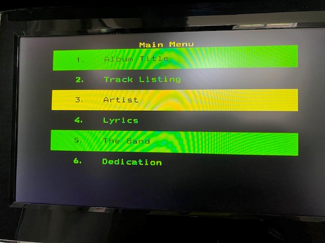

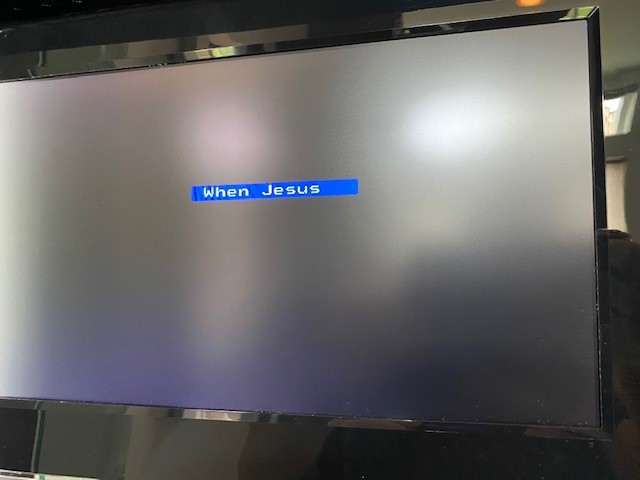

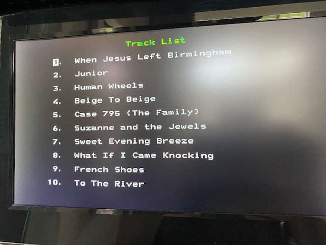

I have attached 4 pictures:
Overview ITTS at 21 lines
Track listing 1 line
Track listing 2 lines
Track listing 21 lines
