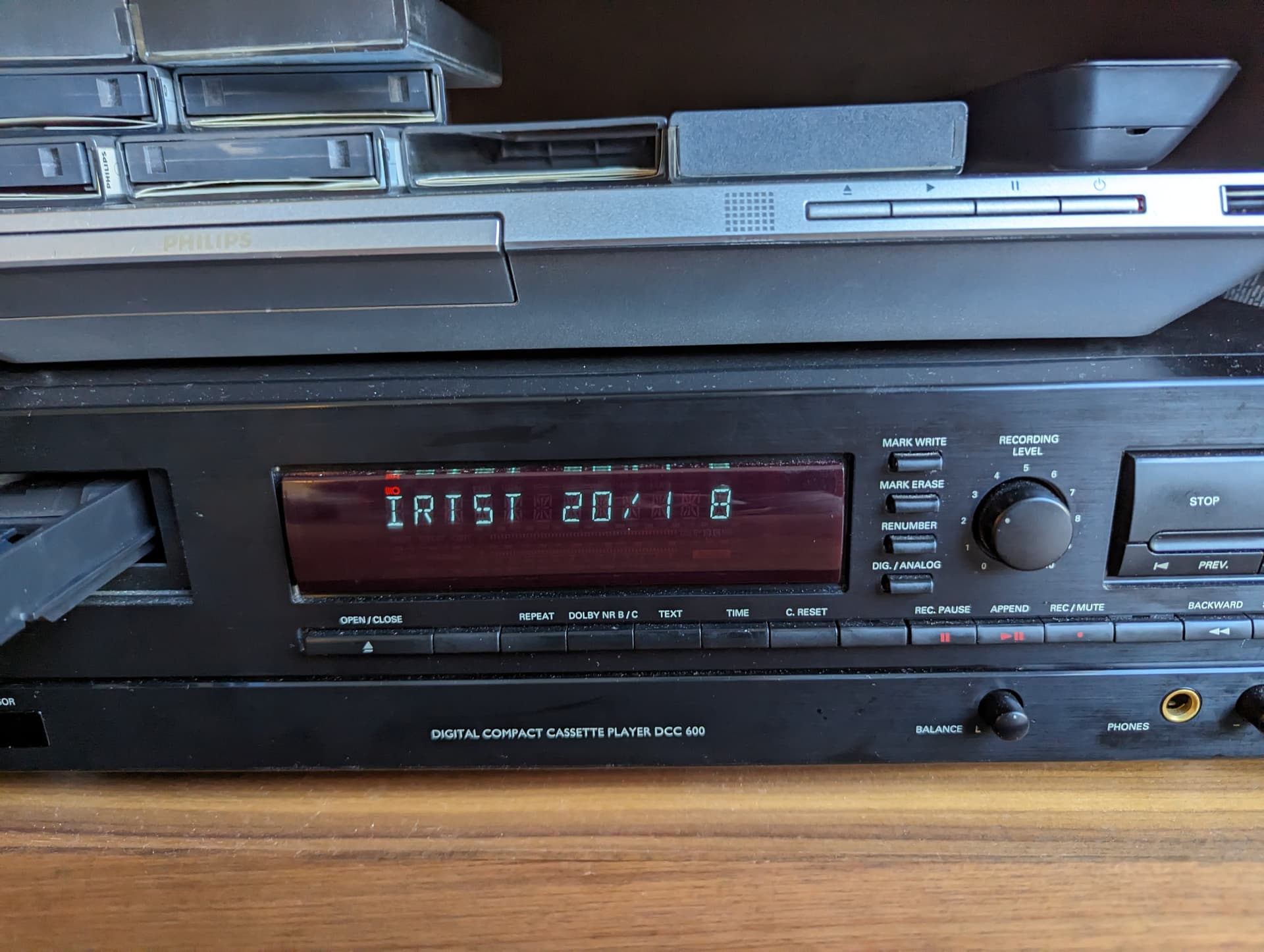

The display shows that during the IR test the unit was receiving an RC-5 code which the DCC600 does not use i.e. 20/18 which is CD player/ Brightness +. The DCC600 responds to codes for device 23 (Recorder 2) so for instance when you press the standby key the display should show 23/12 which is device 23/command 12 or Recorder 2/standby. The most likely reason that your device is mis-translating the codes as CD ones is that the batteries are low in the remote (as Jac has said) or that you are using the wrong remote (i.e. one for a CD player).

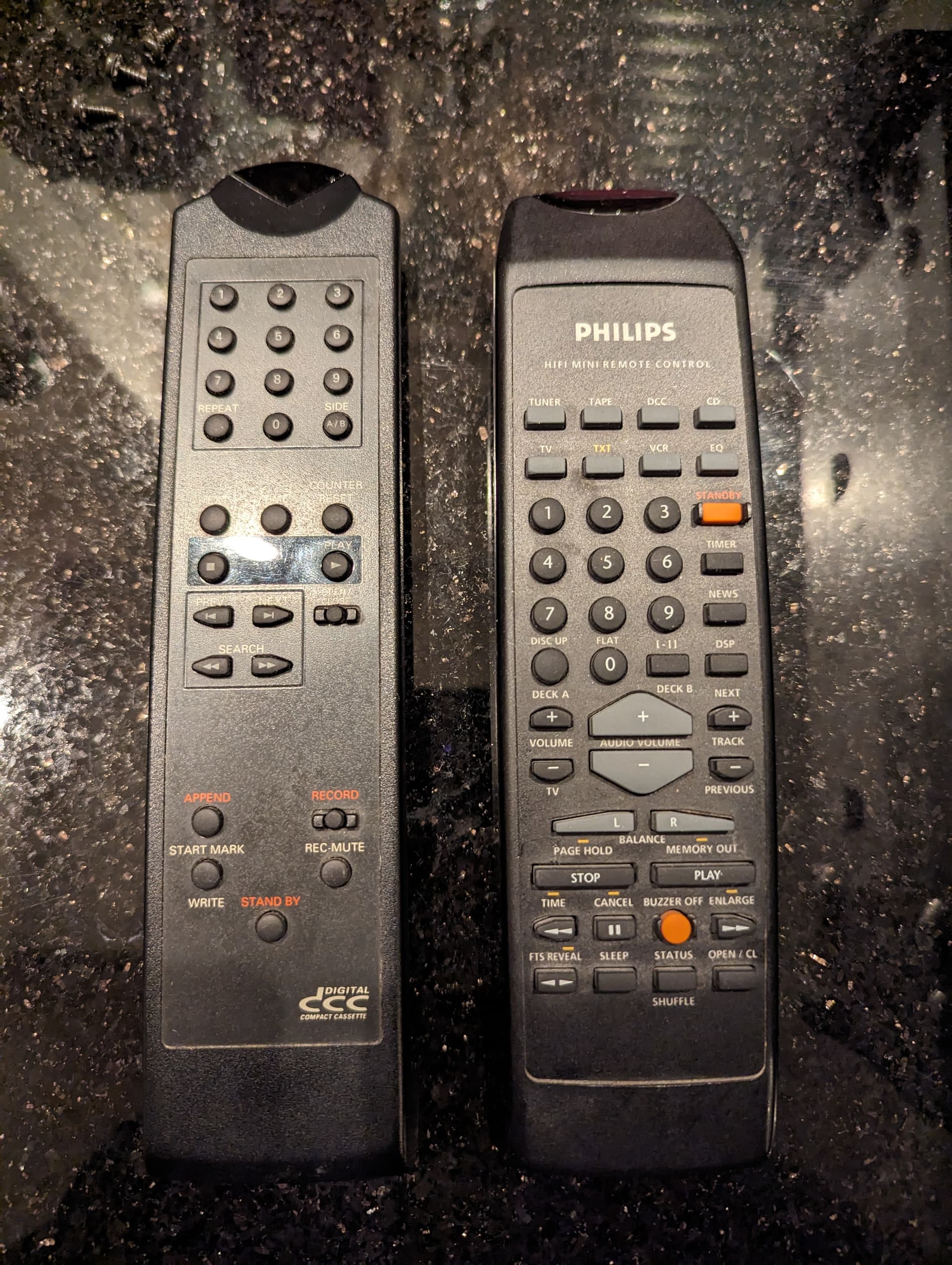

Hereby I send the picture of the remote. The one one the left is not working on the dcc600. The universal remote did work. But I’m sure the old one worked before. So I have a working remote at least :wink:
Most likely the original remote is broken. They are often offered for sale, so a replacement is easy to find.
Is there a possibility to fix the old remote? I didn’t open it.
If it’s a simple problem like corroded battery contacts or dirty buttons, yes. But the electronics are all probably in a chip under a blob of epoxy and there’s no way to repair that, as far as I’m aware.
I’ve never mended one of these remotes but I’ve mended tons of other makes from this era. First remove any screws you can find. You’ll then need to make yourself a “spudger” out of a thin sheet of clear polyethylene (an off cut of a blister pack will do) to insert between the two halves of the clam shell so you can work them apart. Most remotes are snapped together and this saves your finger nails. Once apart there will probably be a rubber membrane for the buttons and carbon tracks underneath it on the PCB. Often moisture collects here and all you need do is dry it out. There will be a single IC where the remote codes are programmed and what you are looking for is a small yellow box marked 455. This is the 455 kHz crystal oscillator and its either faulty of needs re soldering. If you are lucky its the latter. If not they are readily available for cheap - its worth a try because your remote still works but the codes are corrupted and RC-5 is all about timing so its probably a dodgy crystal. Good luck.
