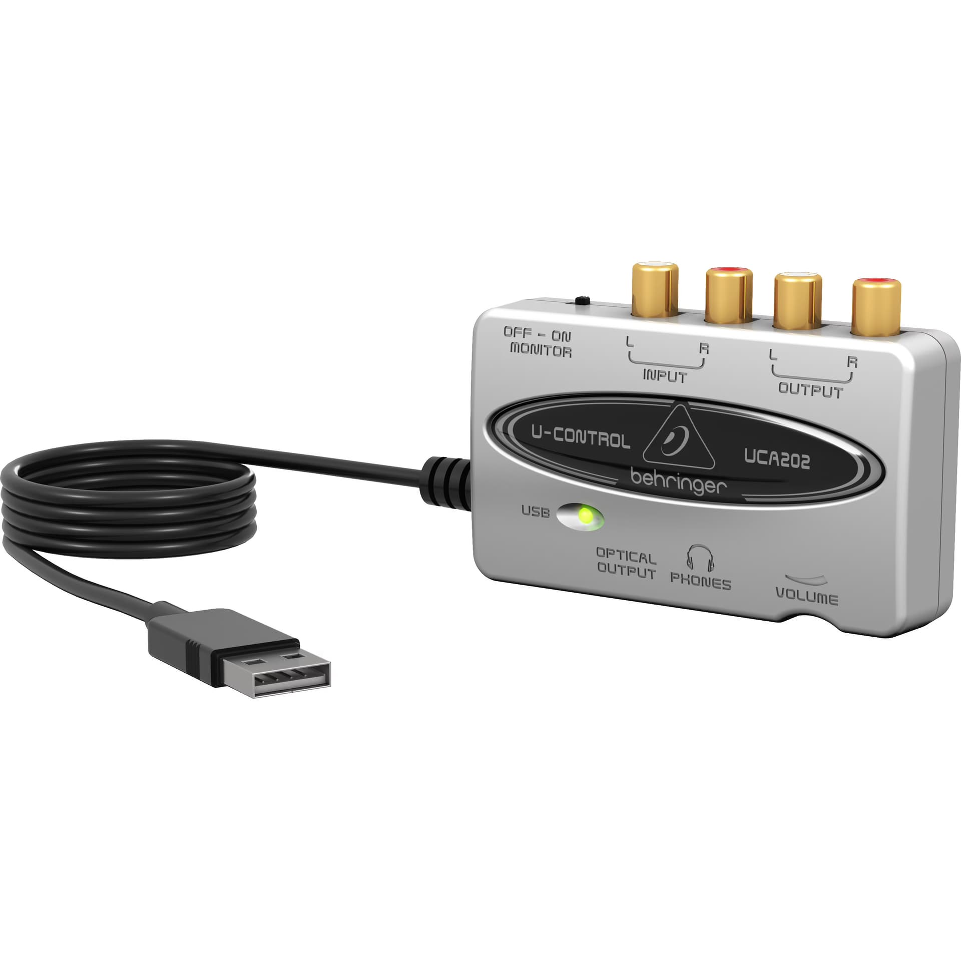

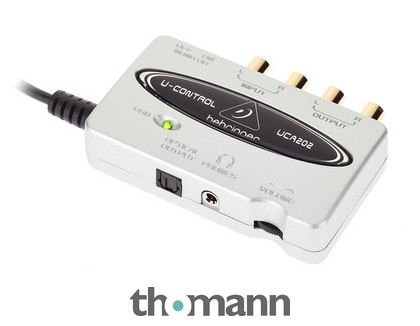

easiest solution:
Where can I buy this?
Many devices of this kind are available online from places like Amazon and Alibaba.
for instance here:
Thank you for the tips and advice. I now own the tool that is shown by PvdM. It works easy and simple and I have already copied my first music from my laptop to DCC. Works great.
