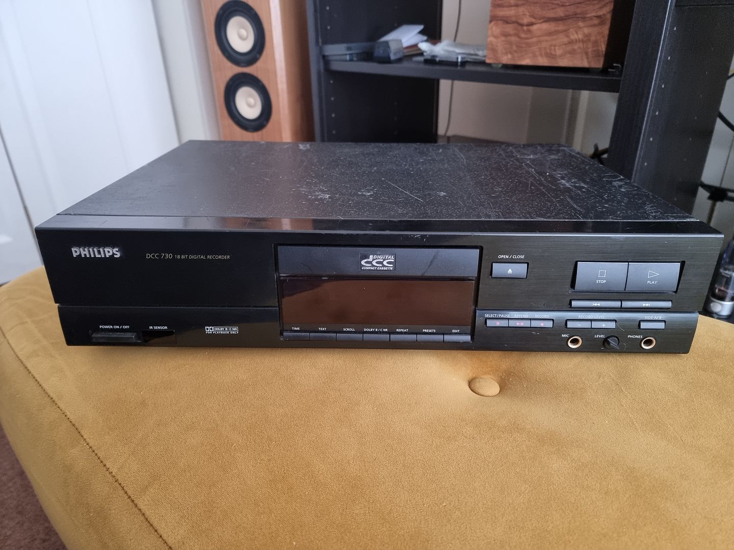

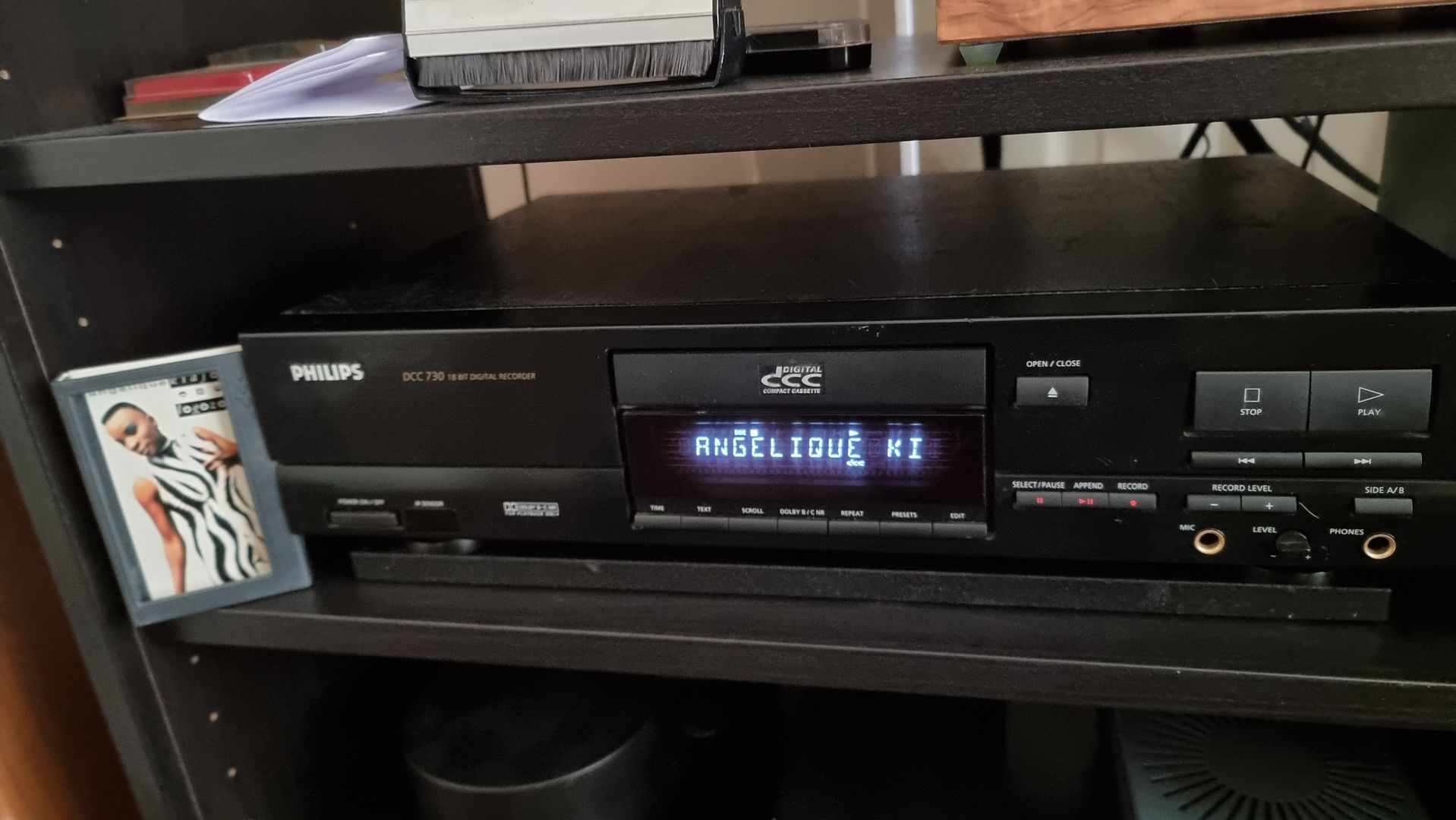

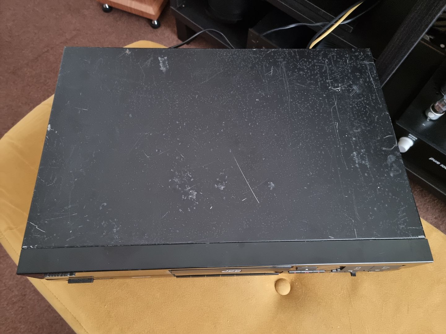

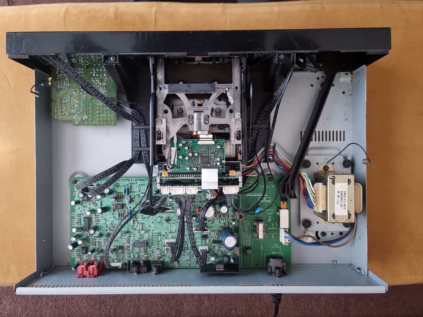

A few pics of the DCC player (the lid needs a respray so waiting for the summer):

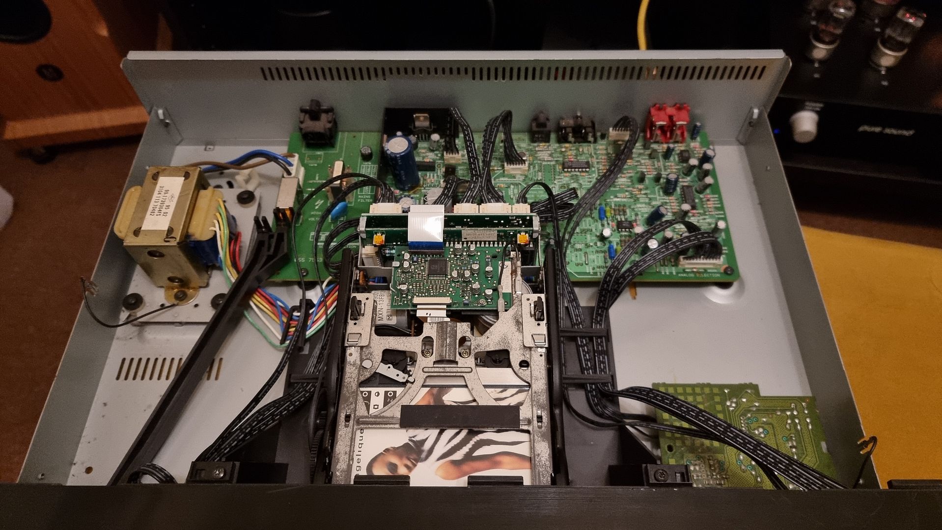

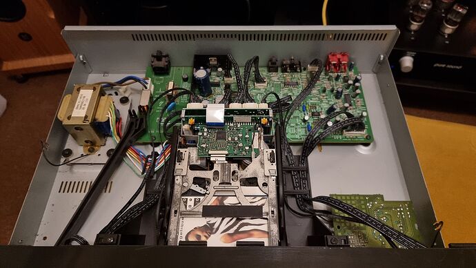

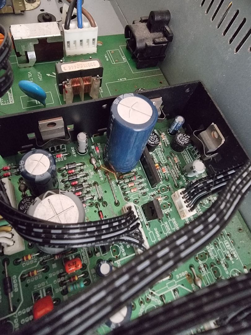

The insides - looks like one of the caps is on its way out (could be the reason for the dropouts?)
Thanks
I just send you a PM.
The brown goopy stuff around the electrolytic is just glue, not leaked electrolyte. That capacitor is part of the power supply and it’s probably fine. That being said, when the glue gets old it often starts conducting electricity so it’s probably a good idea to get it out of the way, but it’s almost certainly not your problem. If your recorder has capacitor problems, it’s probably the ones on the read-write board on top of the deck.
However, even though Ralf tells us that DCC730 with bad caps are starting to appear, they are still pretty rare. It’s more likely that your head is simply dirty or there’s a mechanical problem like pinch rollers or a sticky pad in the cassette. Hopefully your head is still good.
Thanks Jac
The rollers have been replaced. I cleaned the head with a cotton bud with IPA (no dirt showed on it)
Will get another tape that is known to be good and see how that goes.
