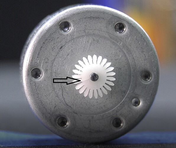

After reports last year about noise coming from the 3rd generation Philips 951 and 730 during FFW and Rew (not playback), we started investigating. Slawa reported this first and mentioned the cam gear. We now have several units with this problem all over the world.
We have concluded the research and it is indeed the cam gear. It will crack at some point. A similar situation we have with the 2nd generation DCC players.

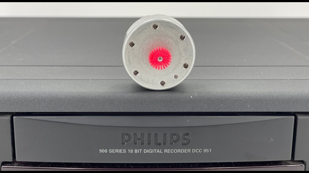

Krzysztof and his team have been forwarded this information and we can used harder / basic resin for reproduction. The material can be similar to the Technics AR-1. We will do a few test runs and make them available after being ok’d by the dccmuseum team.

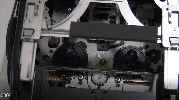

The pictures will show the location for the gear. The video is an example of the sound to be expected when problems do occur.

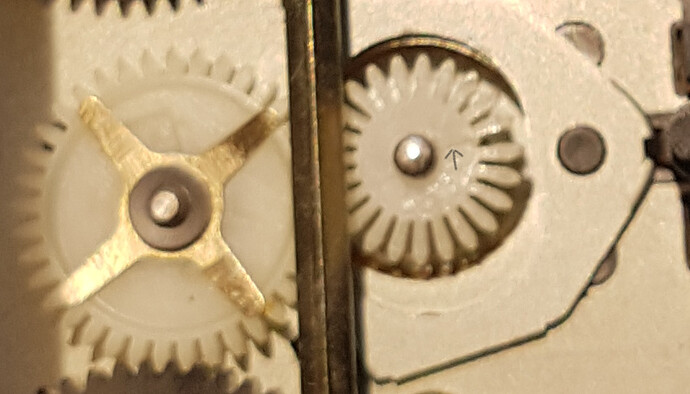

Hi Ralf. I just was looking at one of my older DCC-951s (not the one I purchased from you; one I imported from Europe in 2010) and it is in fact showing a single crack on the cam gear.
It’s only a single hairline crack, so it’s not yet causing any operational issues, but it is indeed apparent and I’m sure it was not there when I last serviced the machine a few years back.

We are interested to see if you can make 3d work as we are considering molding. We have so far done a couple successfully but they are still not tested.

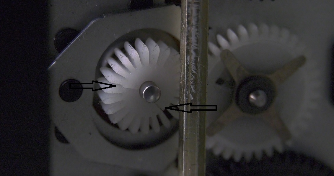

My 951 has this issue. Until now I have not been able to find a replacement.
The noise is obvious with fast forward or reverse, but can also be heard when playing.
I admit the crack is a little hard to see on the photo.

Welcome to the forum! The new gears are now available to Patrons of the DCC Museum.
