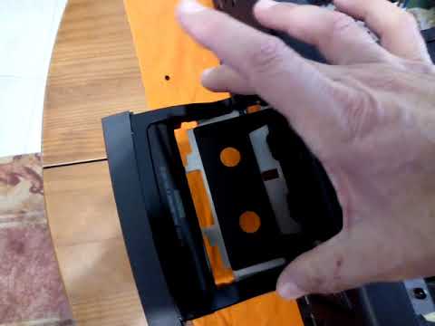

Hi Ralf, I already managed to repair the cassette loading unit, I was really stuck, I disassembled the cassette unit and I was able to put it back in the rail, can I send photos?

Feel free to upload your photos here by dragging them in or clicking/tapping the upload button when editing text. I would be interested to see them.
Ok, thanks, I send the video link, already fixed, and in the comments what was done, it was nothing complicated, just dirt on the bottom rail of the tray, which also helped in blocking, the top plate of the bent cassette and the drawer assembly disengaged, I carefully disassembled, based on your video, I took the opportunity to clean and lubricate the mechanical movement system,
