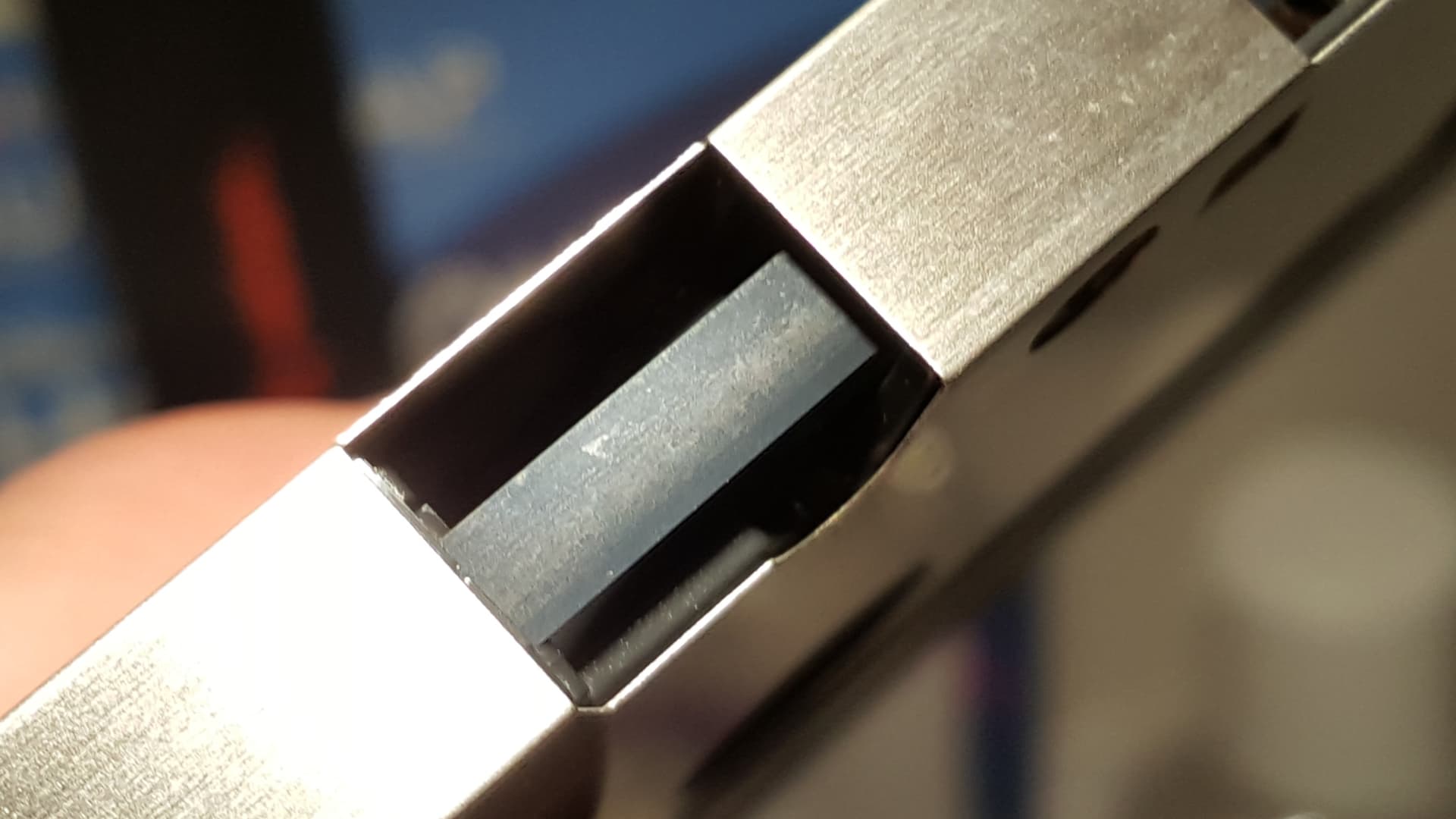

I stopped the tape at the most severe spot and ejected it and looked at it and it had a matt greyish goo/film on the tape.
I tried to clean it with IPA (as the video posted on YT by DR DCC shows) and managed to get it much better, but the drop-outs still persists the exact same way they did before the cleaning.
But it’s more than likely that this tape is too far gone. This cleaning method is for tapes with minor drop-outs. Not as severe as this.
Strangely though there’s no drop-outs whatsoever when playing the b-side at the same spot.
I guess there’s nothing more I can do to try and save this tape.
I just can’t believe it!!
As a last solution I tried to clean the felt pad as shown on YT by DR DCC and holy macarony the tape plays almost flawlessly through that deteriorated part 8:57 - 9:12 now.
Only two minor drop-outs where the sound totally disappeared before.
Pure magic!
Probably someone didn’t rewind the tape when they last put it away. This is unfortunately all too common with DCC’s.
