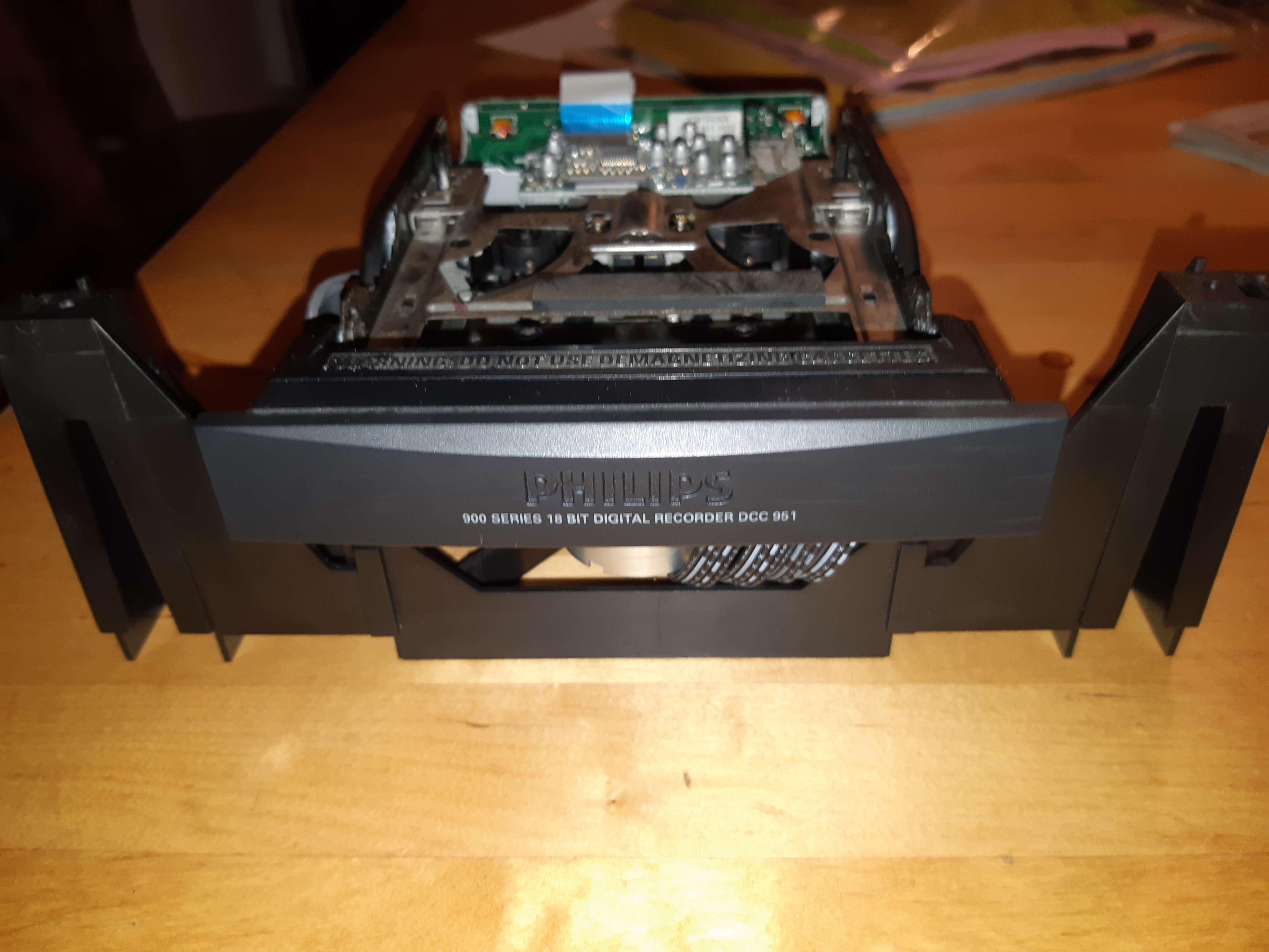

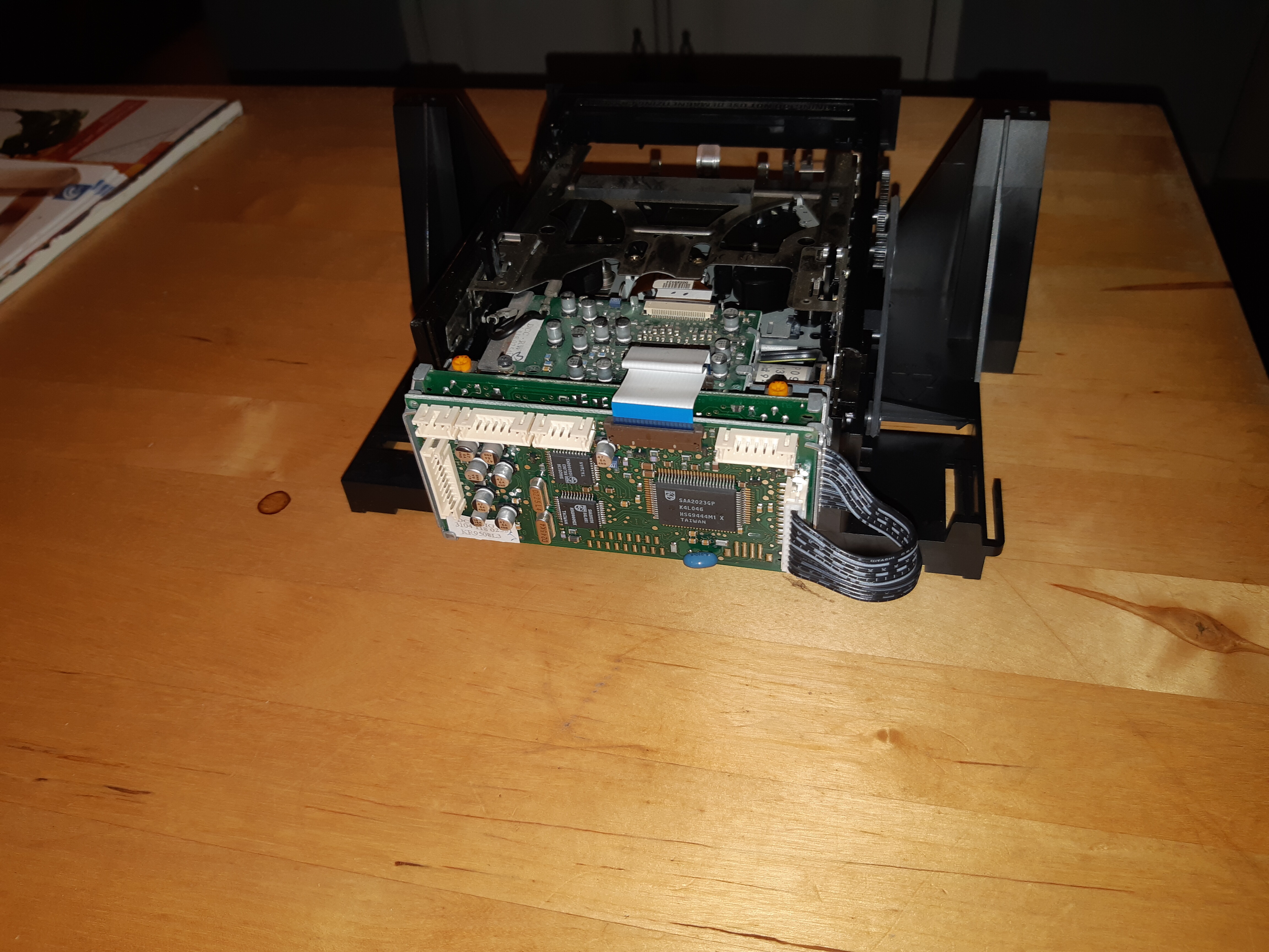

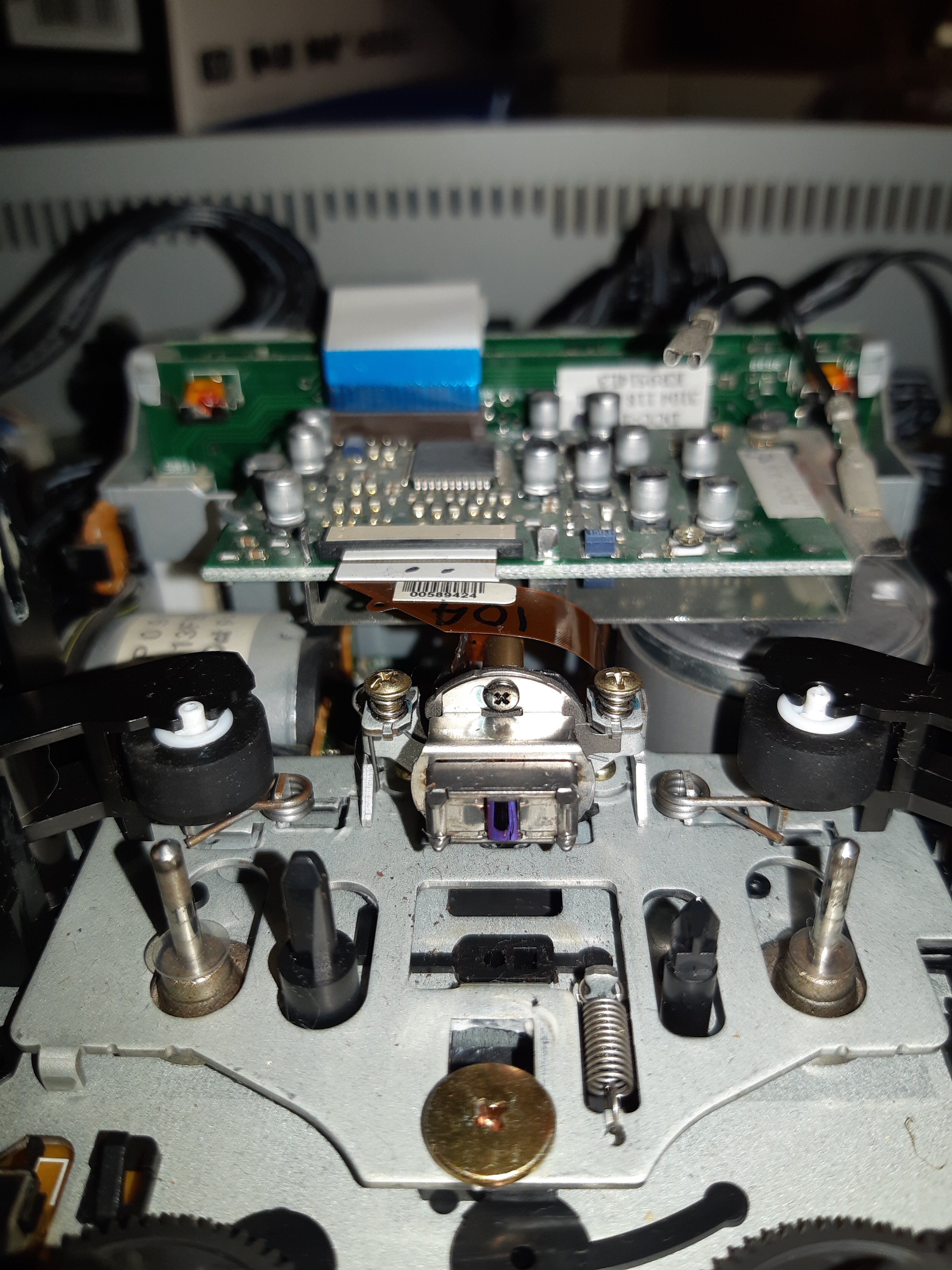

I got this 951 comming my way for 25 euro. The head was dead or dirty. I took some pictures, and my guess is a dead head. Are there any spare heads laying around ? Is this not to be rescued or just for parts ?
The DCC museum got a donation of a small amount of heads, these are not for sale. No other spare heads are known to exist anymore.
Either you need a donor head from another DCC951/DCC730 or this can be a donor for repairs of other DCC951/DCC730.

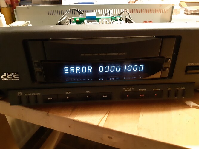

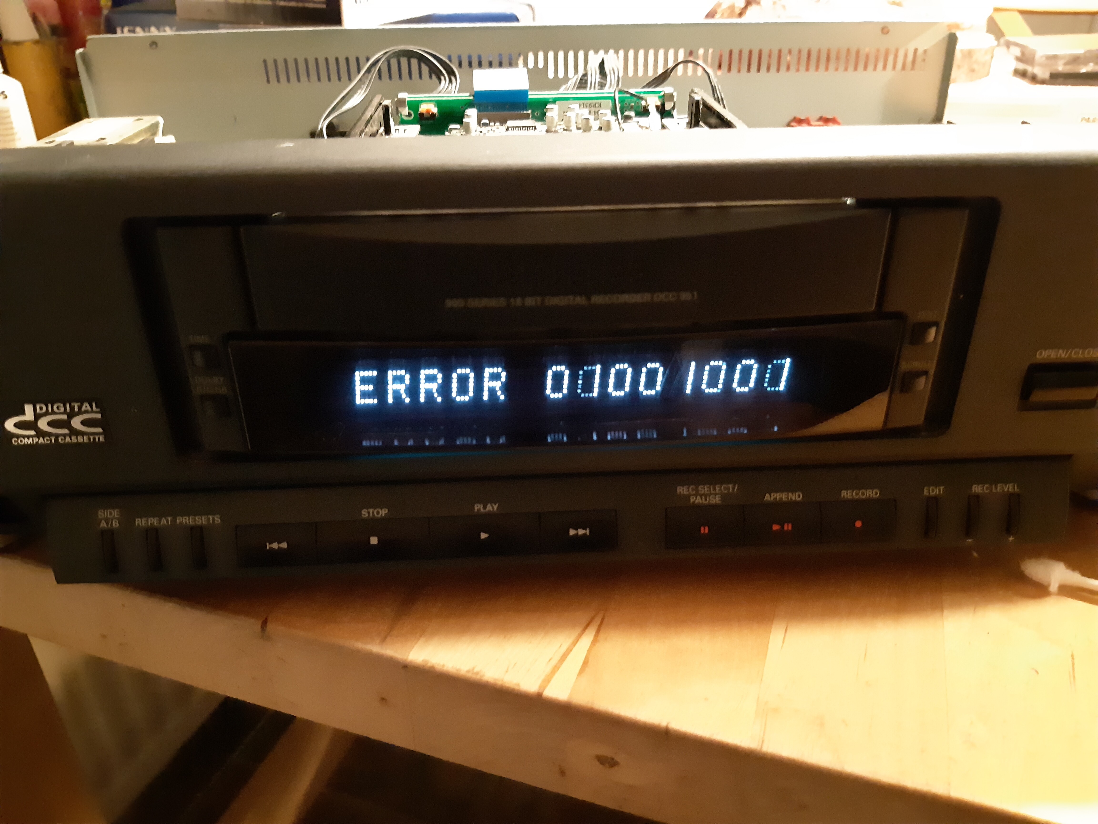

I was afraid of that. I’m not a repair guy, so i probable gonna sell it to a repair guy. (The seller sold it for 70 (as untested/ repair), but i let him run service- mode, and he got 3 20 error, thats how we found out. I took a change on it..it could have been dirty.

Besides what already has been said, it looks like those capstans could really use a thorough cleaning…
Hi Ton,
This might change nothing to the state of the heads, but please always clean your capstans thoroughly before testing. These look very dirty/rusty. It may even damage your tapes.
Regards, Henrie
update: I see Jac made the same remark :wink:
I see the rust as a hint that (poor) Type I analog tapes were used that kiled the head.

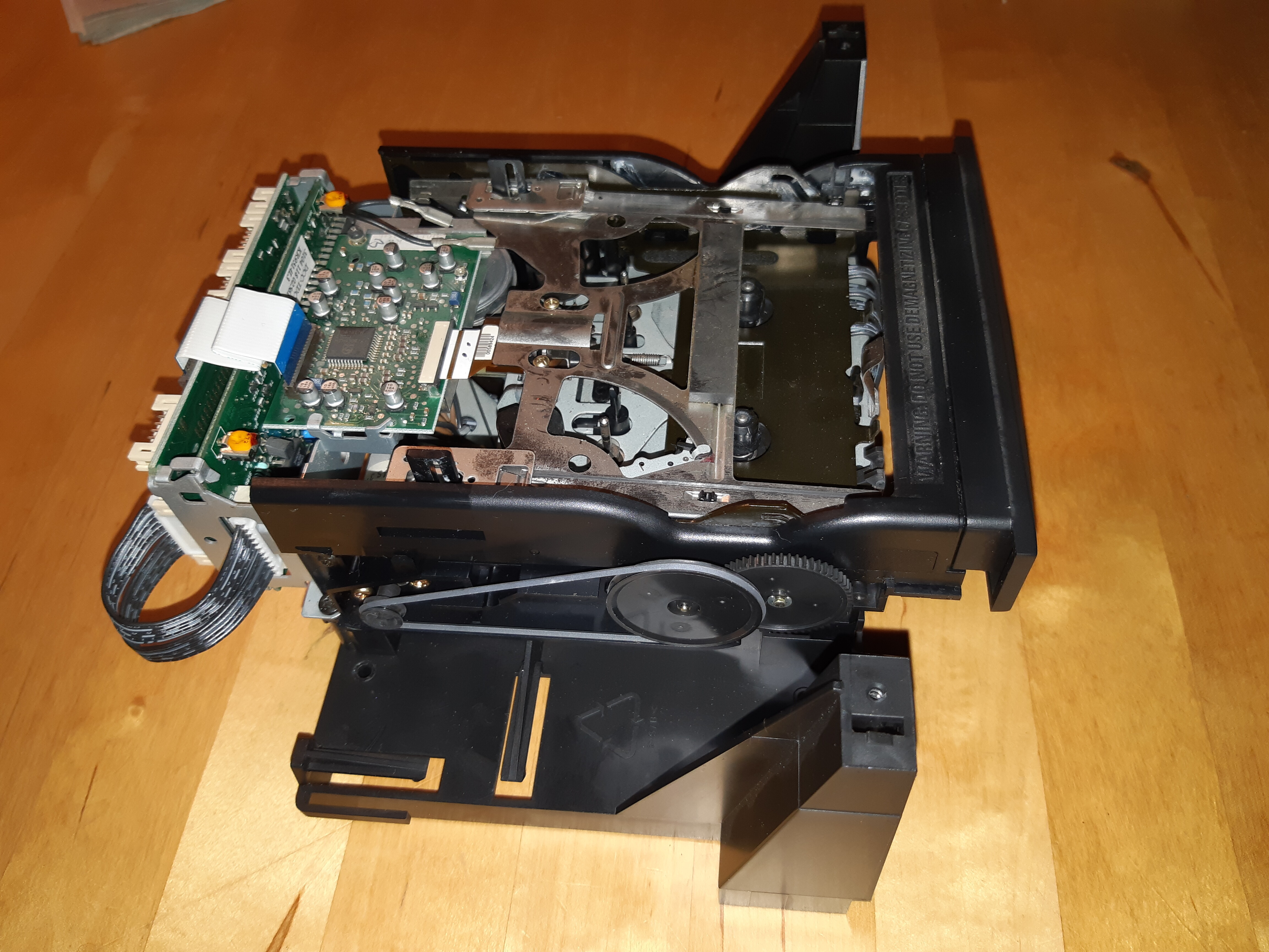

You all won’t believe this..last night i thought..lets check on e-bay to see if something is on sale (on the DCC department). Twenty km from where i live…there was on sale a complete mechanic part (the big block with the head in it) of a 951!. I could pick it up for 75 euro, i replaced it with the ā€˜RIP Head’ mechanic..and now i have another working DCC951 !
And i have a complete mechanic with a dead head, but with all the rest of the parts ā€˜untested’. I’m not this smart repair guy, so i don’t really have a use for my ’ left-over’..so if anybody is in need for something like this. The pictures show my leftover

Max, wasn’t neccesary to replace anything. I just took out the mechanism..replaced the complete unit..and there you are..i now have 2 working 951’s ! One with a bad cover, but Mick Jagger told me to ā€˜paint it black’ ! I’m gonna test the ā€˜new’ one for a week or so..and then probably sell it or trade it.
But as it is used, replacing belts and pinch rollers is recommended to avoid damaging tapes or making bad recordings.
