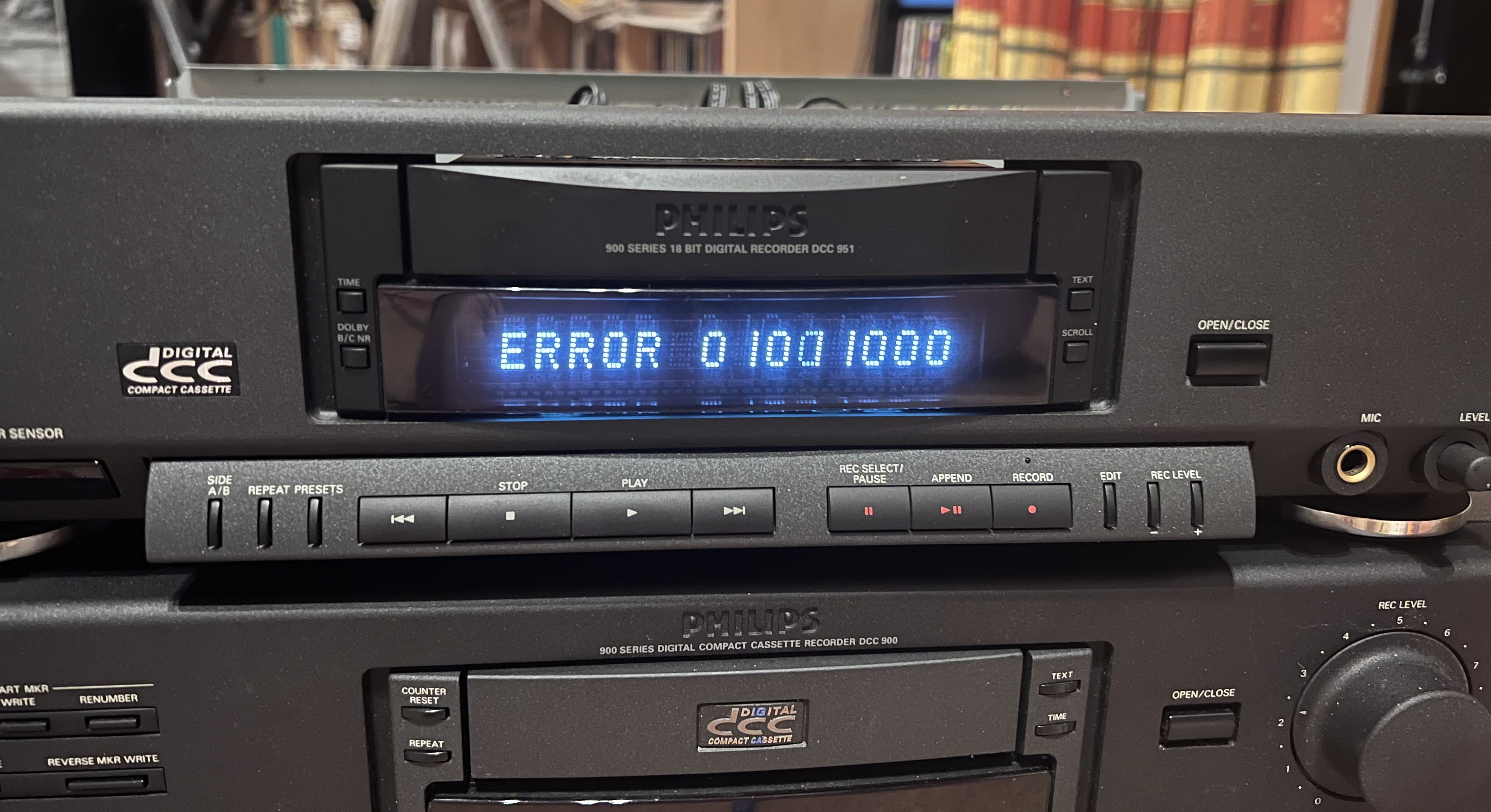

Thanks for the pointers.
I gave the head a thorough and lengthy clean with IPA and Revox pads – it was very, very dirty, but no cigar. It counts and sees tracks though!
I wouldn’t get any DCC sound with hardened pinch rollers then?
They don’t have the holes but yes they are a little hard.
I’ve cleaned both capstans with Brasso, they look ok now.
No wow with analogue tapes (classical music).
Also I’ve noticed that the three SMD caps at left on the headboard get very hot. This can’t be right, can it?
Edit: found that thread, no news.
Voltages are ok, 5, 8 and 10 V.
I don’t get the 900’s dreaded FFFFF :face_exhaling: but there are errors, two or three ones. They change when I try another cassette! See photo below.
