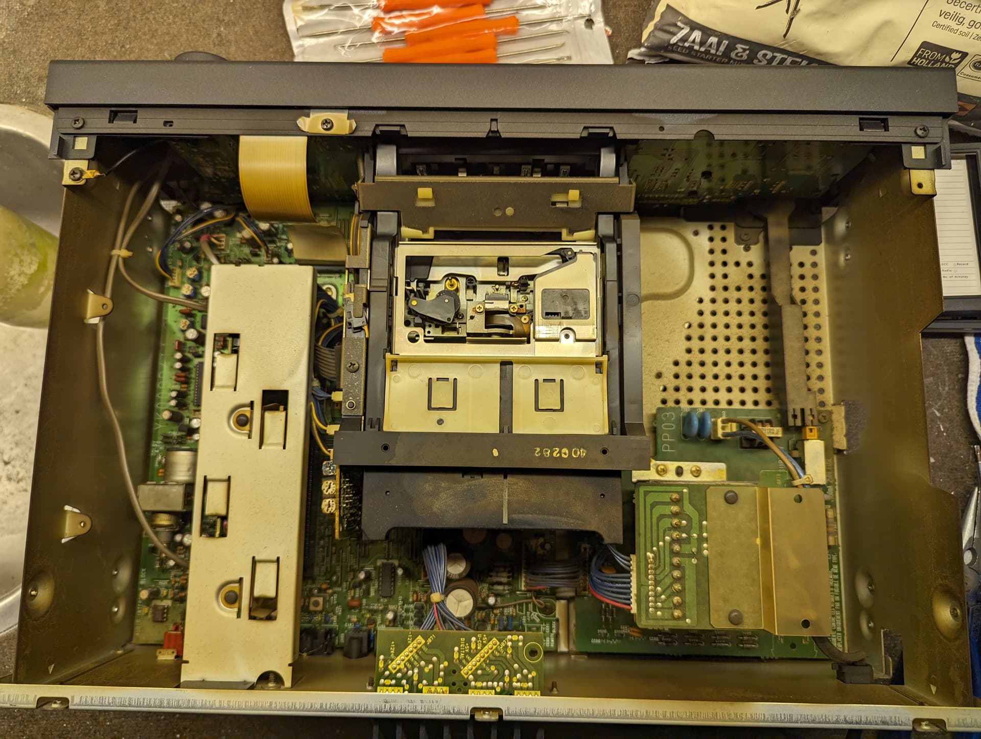

. They smoked 30 years nearby the player. See picture below, never seen a yellow DCC before. Normally I won’t even start on a player like this. It isn’t mine and it worked for a day and then stopped with this issue. Only thing I could try is putting it all in a ultrasonic cleaner. Prints looked fine after my Repair.
Hi Roel,
Please first try to clean the sensors with IPA. For sure they will have a smokey layer ![]()
