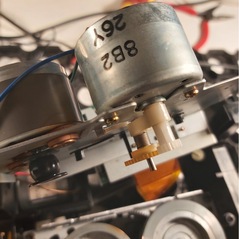

On this unit I could not test boards because the mechanical block is JAMMED. I checked the belts OK but beside that I found a cracked and loose toothwheel on the motor which should spin the forward and reverse. I glued it back but it must be the result not the reason for the problem. The motor cracked the wheel because of the jammed mechanics. Then the wheel left its position and lost contact whith the brown tooth wheel there under.
The mechanical block is now jammed as before. I tries to move the tape spindles in forward but stops with creaking sound immediately. In rev and play it does nothing. There is also no movement or turning of the heads.

I have made a photo of the damaged toothwheel with the crack in it. After removing I found that it has left its Position so I moved it back and glued it later providing free run as needed.

My repair of the spooling gear with the glued motor tooth wheel was sucessful but the mech was completely blocked by an repair vattempt of the seller. To confirm the torgue and play of the spooling gear I purchased another defective DCC900 but it was OK with my glueing.
You can use super glue but make sure there is enough axial play so that the white arm swings free from ff to rew.
To unblock the mech I had to turn the black central wheel to one of the play positions and then reassemble the block.(same procedure as changing flat belt..)
When doing this you should in addition to the known manuals make sure that the belt is not conflicting the white spooling lever. There is a little hole in the metal bracket and you should see the belt beside the white spooling lever.
