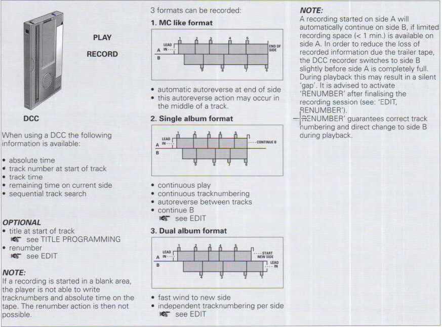

Maybe this can help you:
(from the DCC730 service manual)
Pay special attention to the numbers of the tracks on side B, so you should avoid the 3rd option.
More specific information on recording in section 2-9 of the service manual.
