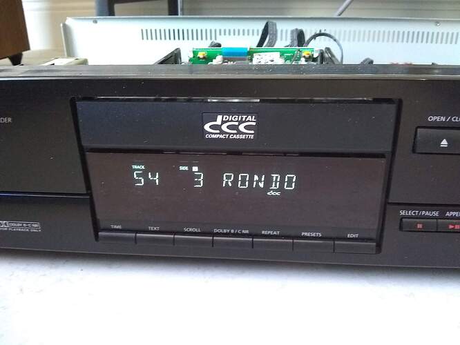

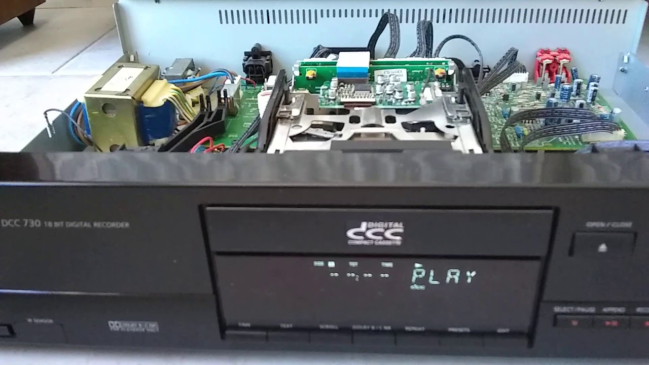

I am having a problem with pre-recorded tapes. When I hit play it skips pass track 1 then reverses to side B then stops. If I manually hit the side A and hit play it plays fine the rest of the tape (both sides). This is probably related to the other issue I am having that it can’t record but I am posting it separate just in case anyone else had this problem and found a fix. I did clean the head, put two new pinch rollers, the belt is in great shape, plays analog tapes perfectly and plays DCC tapes perfectly with no dropouts. See video. Also, sometimes when I hit skip a weird track number that does not exists shows up on the display and will not skip because the number does not exists on the DCC.
Hi, I renamed your post, moved it to the appropriate section and tagged it because this clearly is not a DCC600.

This is your error cause, damaged (or misaligned if you are very lucky) head or read-/write-board.
We know it is not recording so that part of the board is bad. So if I wanted to try to align the head how do I go about it? I do see two screws one for each side.
Not recording properly could also be the head, but let’s hope for the best.
Is there a way to verify alignment? With the naked eye it looks aligned but who knows.
If this deck worked before, DO NOT touch the alignment. It will only change playback to not work well in your case.
Yes it does work otherwise except for not recording (bad capacitor probably). No dropouts and sounds amazing. I will leave it alone and live with it like that for now and send you the RW board.
