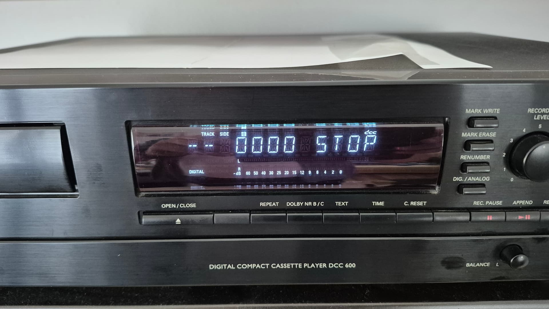

Hi, bought a Philips DCC600, for few days worked OK, the started having problems
when insert the tape and press play it stops after a second, on the display it says stop

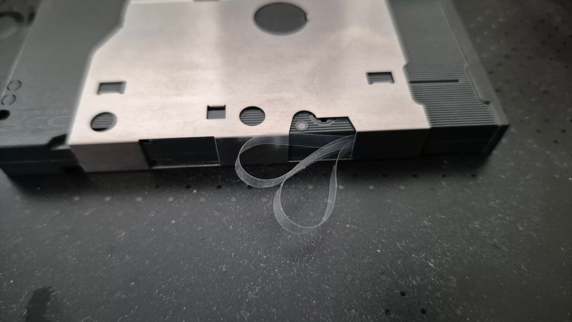

when put out the cassette noticed this

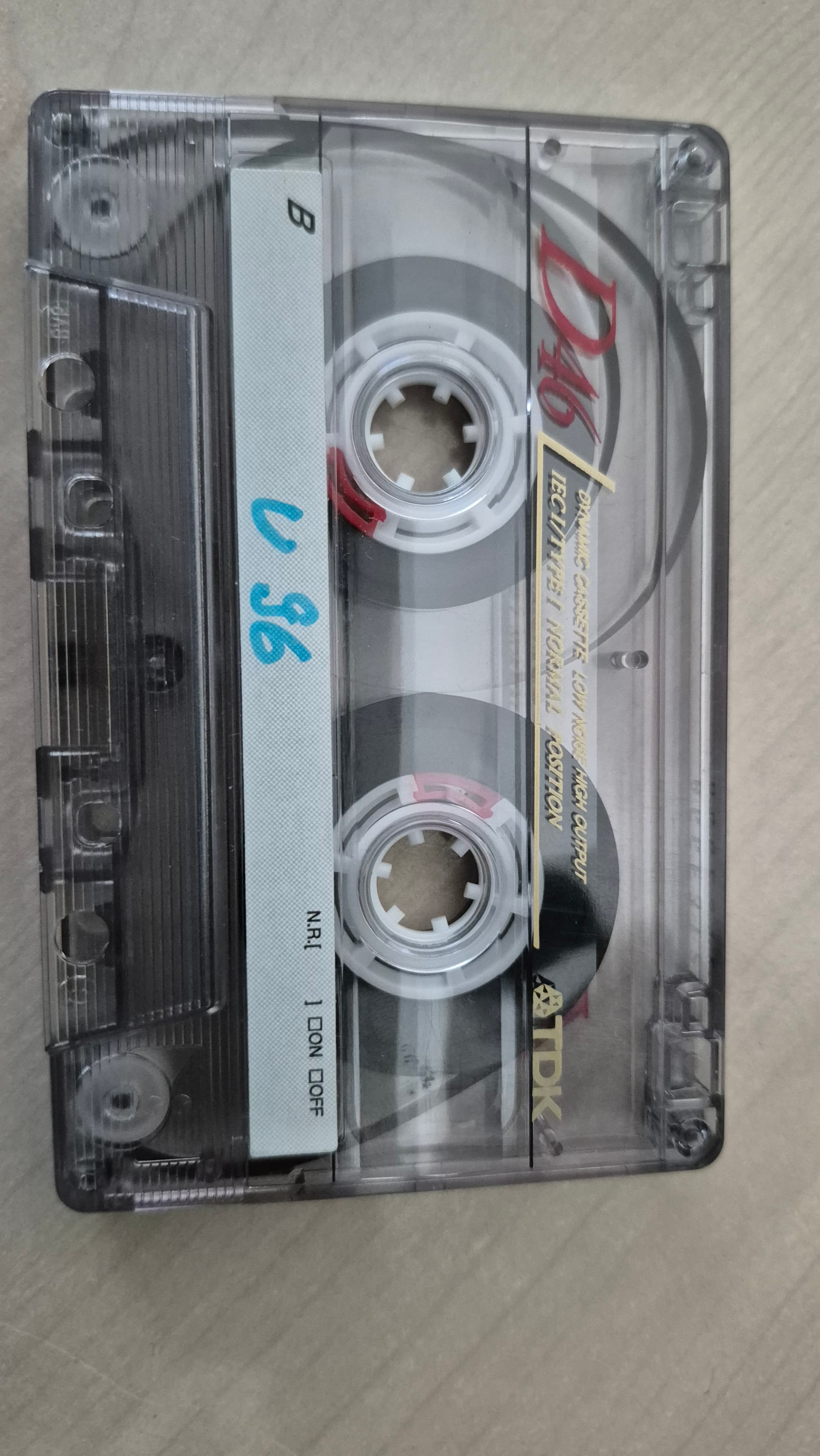

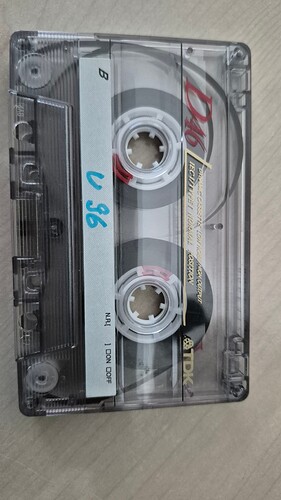

tried with standard transparent casette ant this happens (see the tape inside the casette)
it seems that the front reel doesn’t turn at all, or much slower than the back reel
