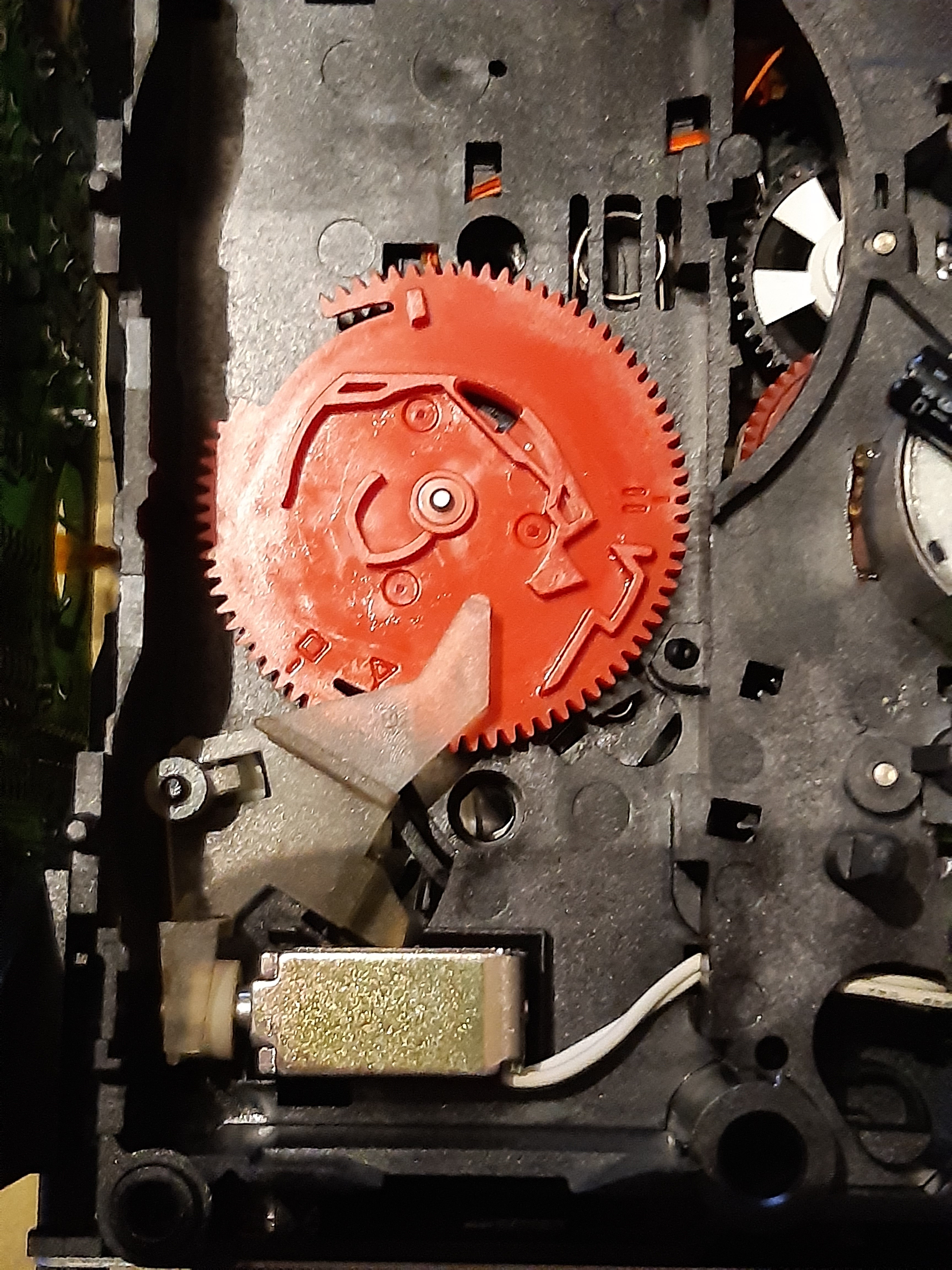

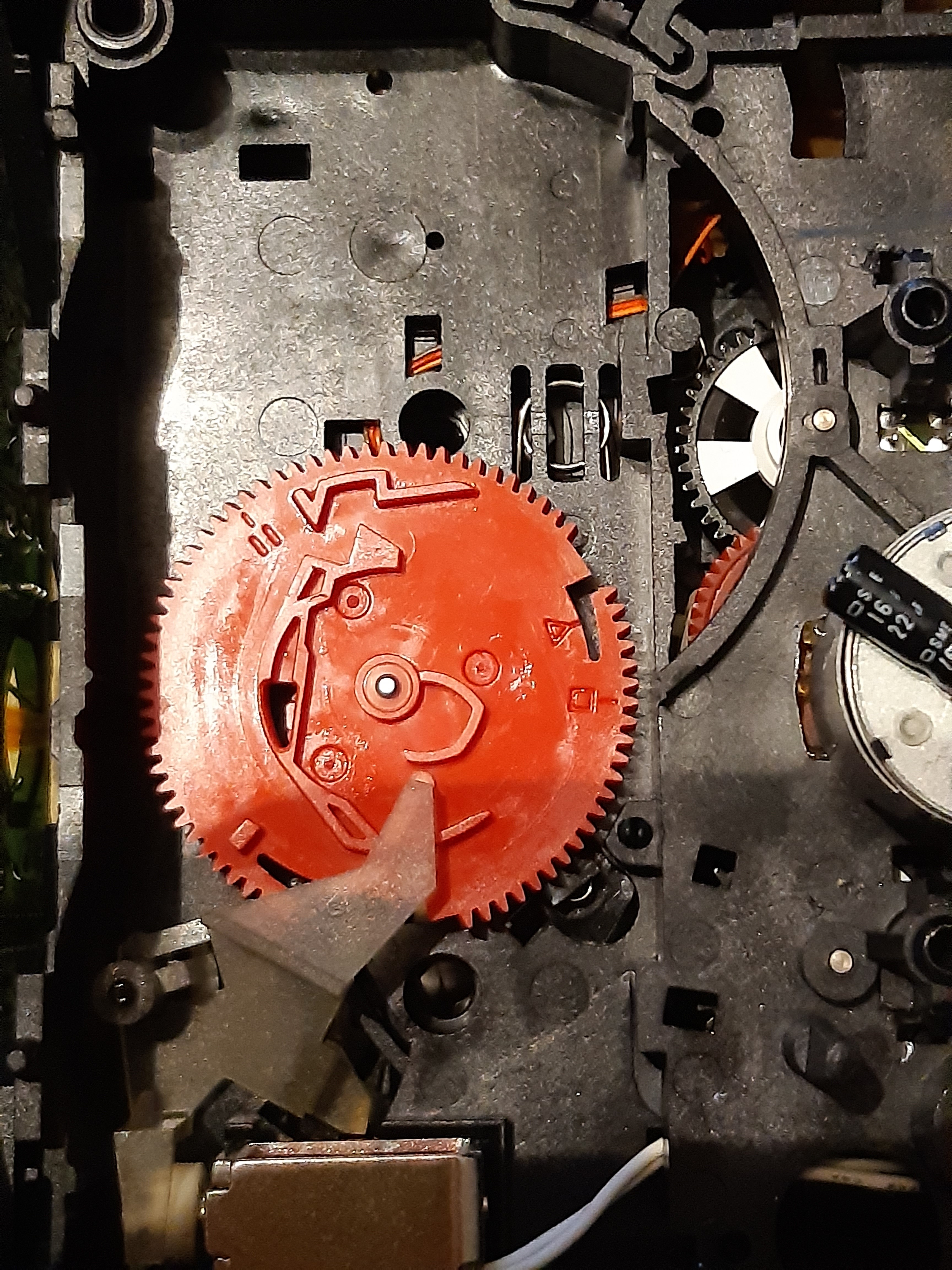

Hallo, I have checked everything and still the same problem.Here are pictures of camwheel. Is this mounted correctly? I have also uploaded a video with the tack tack noise. Can someone help me sort this out?

Do you see the notch on the left of the base?
Turn the wheel so the marker on the wheel with the square is in line with the notch, then reassemble the moving part with the head and rollers.
