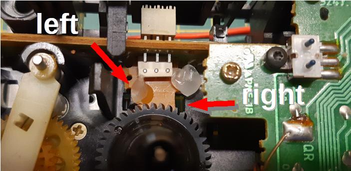

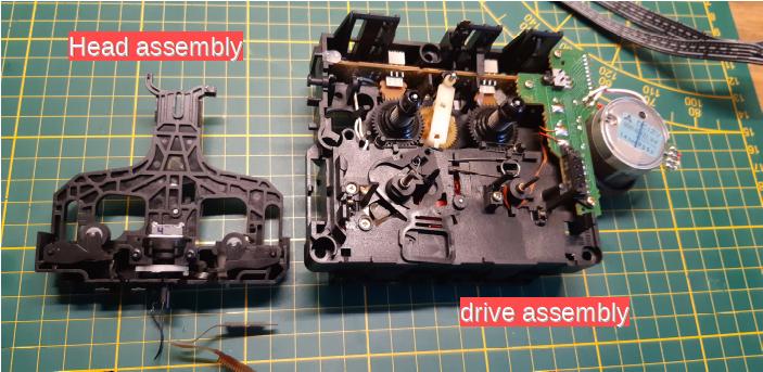

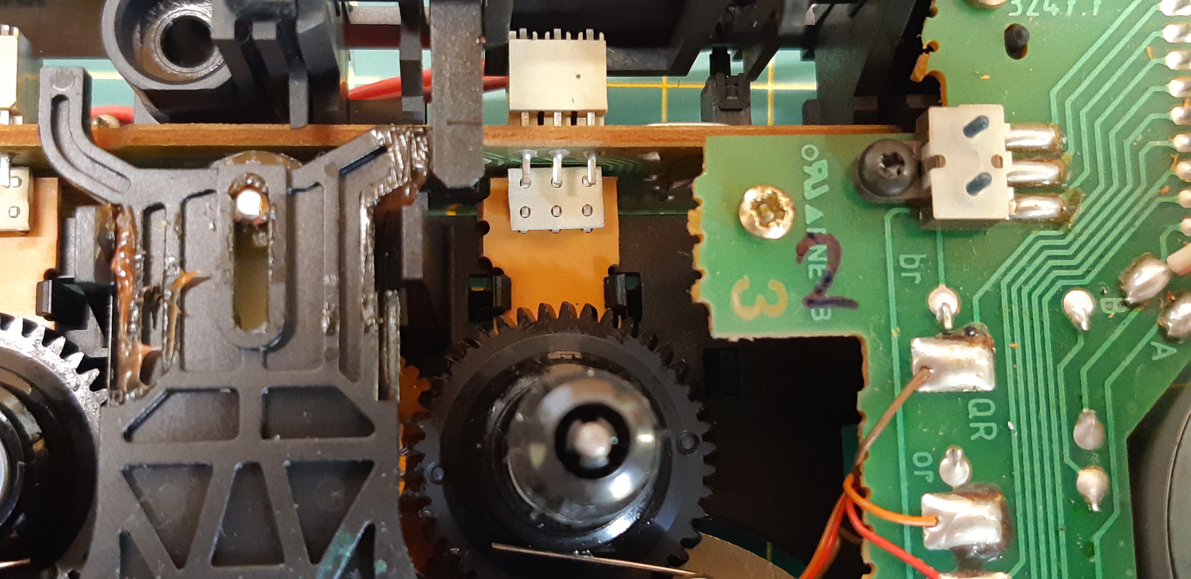

You can clearly see in the picture of the drive assembly that the right clamp that should hold the small brown PCB is missing, it broke off. Therefor the position of the board is not perfectly aligned for the ‘motion’ sensor. I tried to glue the left and right part it as you see to keep it in place but it did not work reliably.
Now, as suggested, I will swap the complete head assembly with that of another machine.
