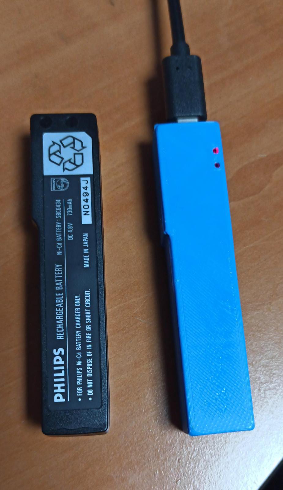

Most likely the belt. This can be replaced.
Forget the battery, but that can also be replaced if you want to play your DCC175 on the go.
That’s something i can do.
And ..
USB-C Rechargeable :slight_smile:
Andre
@Andre_Heskamp where did you get that?
@pvdm Made It myself.

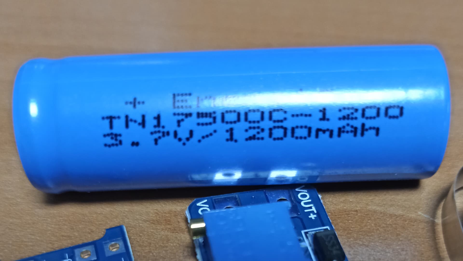

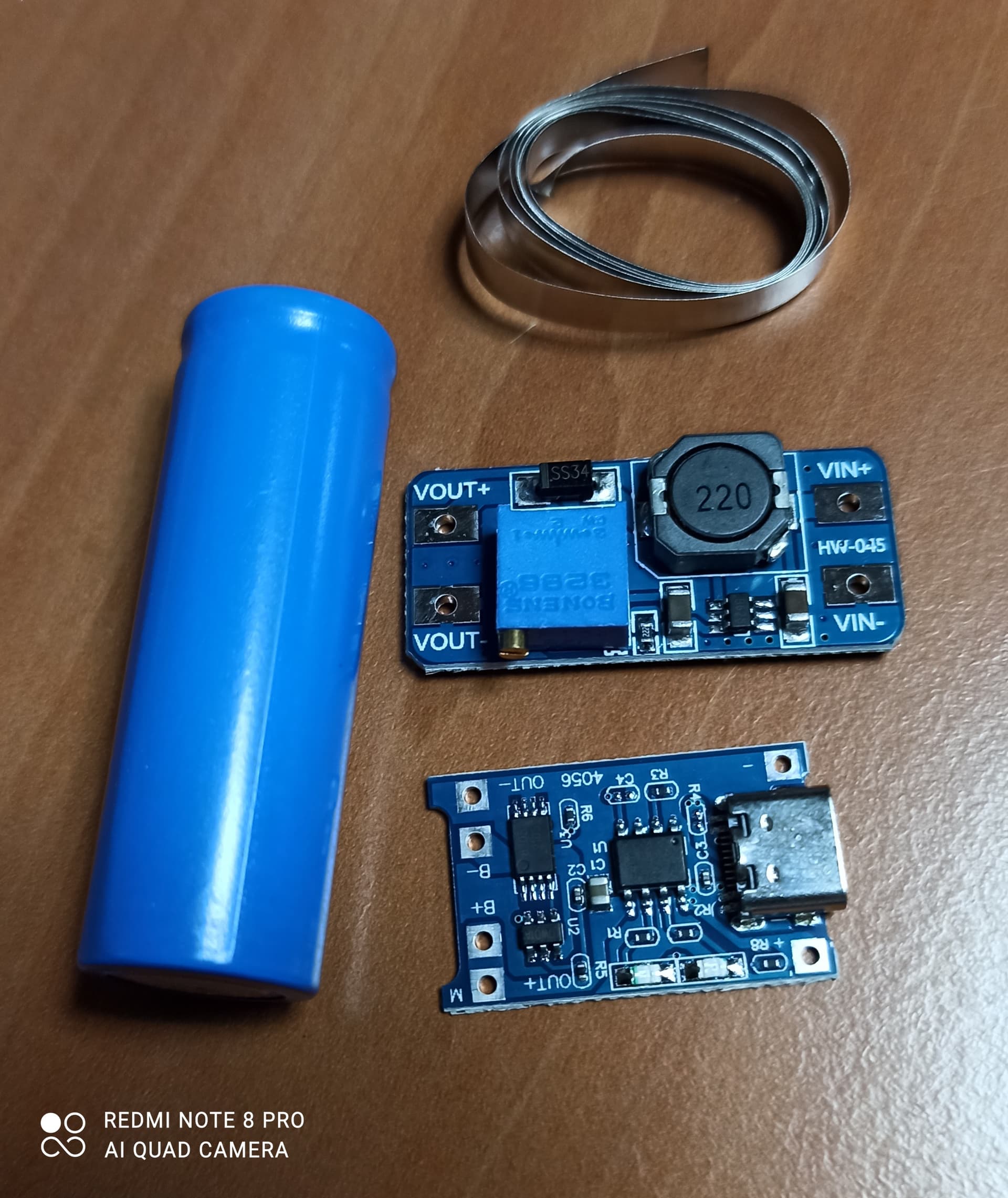

Nice work. What’s inside?
