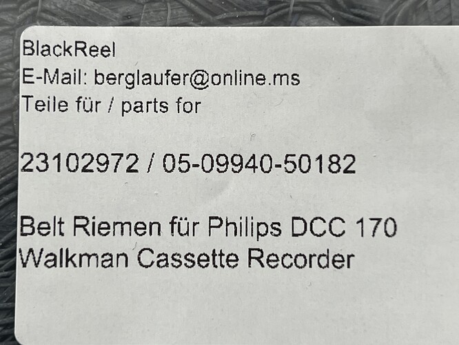

I don’t know the excact measure of the belt but here is a picture of the bag label it came in. Does it tell anything?
The old belt was still in one piece, just streched, so I don’t think there are particles left in motor.
