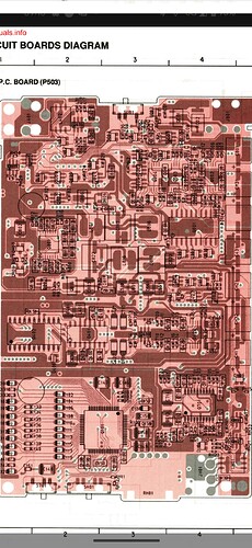

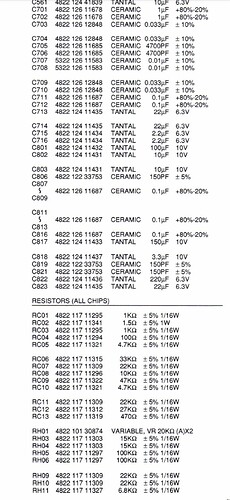

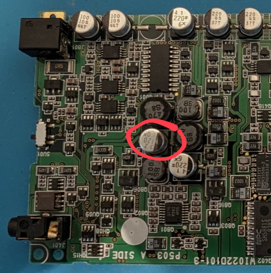

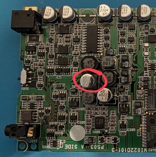

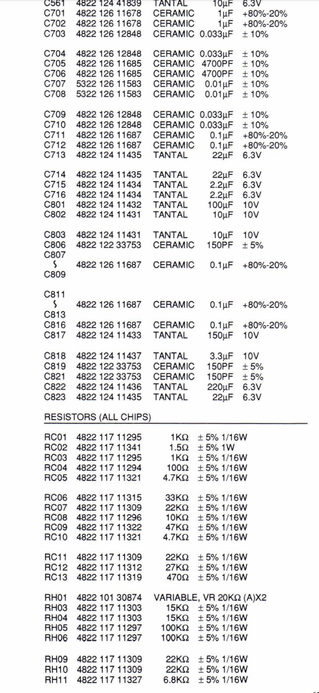

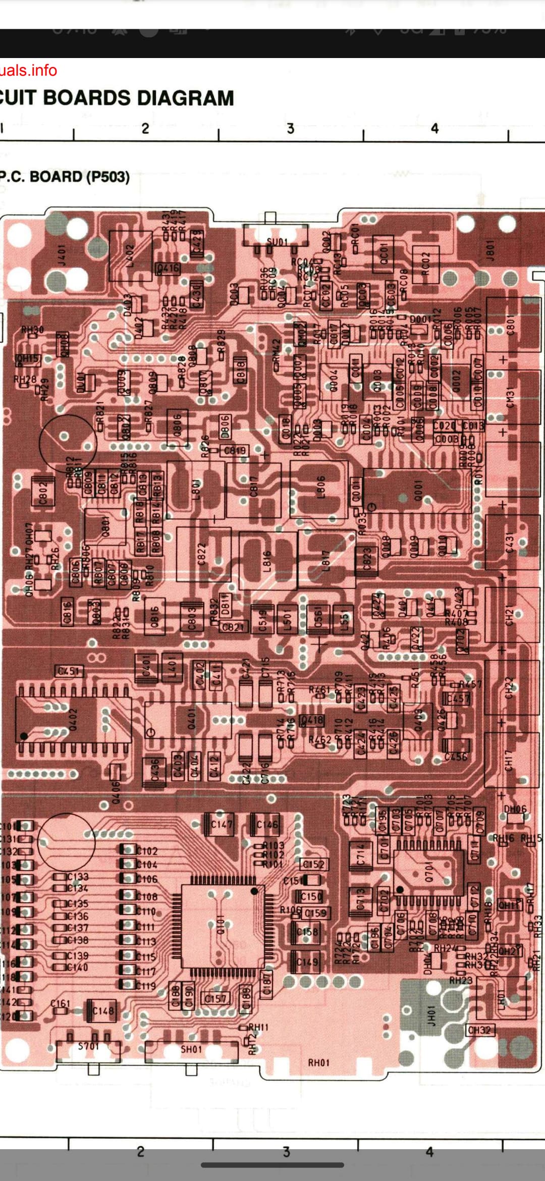

Hello all, over time I have repaired several portable DCC 134 players and I always take pictures of them before de soldering any capacitors. This “funny” thing came up. As you can see in the pictures below I have found a OEM capacitor with a different value at position C817 (120uf) . Is this a mistake? According to the service manual it should be 150uf. I have replaced it with the one mentioned in the service manual.

I have looked at 3 boards here and they are all 150. That is the correct value.
Really strange.
Ralf, thank you for your reply. Maybe produced on a Monday morning :wink:. It seems that even at Marantz a mistake is possible. It could possible that more 134 in the field have this mistake.
