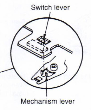

Is the Side A-B switch still ok? This breaks a lot as it is very small when assembling again.

Ralf,
Do you mean this part?
Yes, it is ok, I am always very careful with it and make sure it is aligned with the mechanism.

Yes that is the switch. I would do the motor next. The 170 can be used. I have replaced 2. So far.
