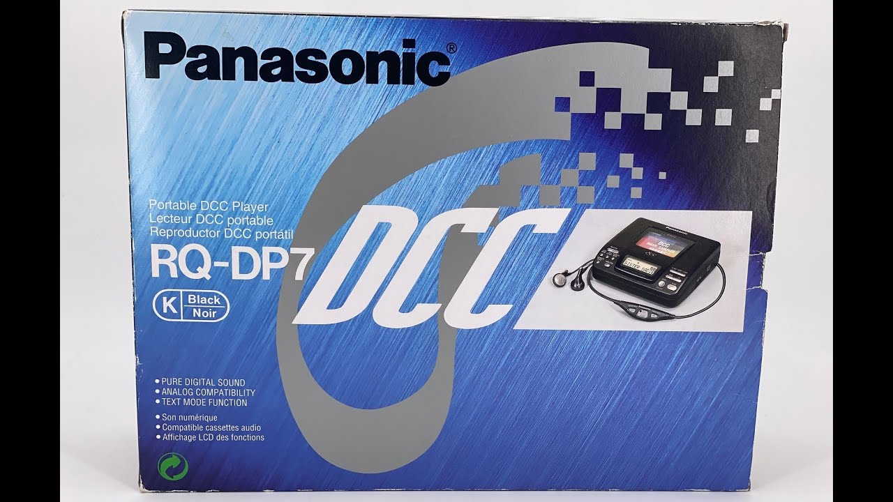

Some instructions can be taken from this video about the Victor and Panasonic as they are the same machine.
