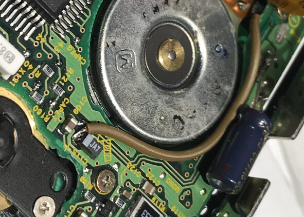

Hi, I had the same symptom with multiple DCC 130 after replacing the old capacitors. I found that one of the via’s that connect the top and the bottom side of the print was damaged by the leaky capacitor. I have used a piece of wire to make a new connection.
You might want to check the via’s with a multimeter.

The answer was already in this post. Check the via’s from side A-B. There could be a loose one. Also make sure to replace all SMD capacitors, while you are working on it. Though this might not help the speed issue, the SMD capacitors are leaking and can cause more damage.
