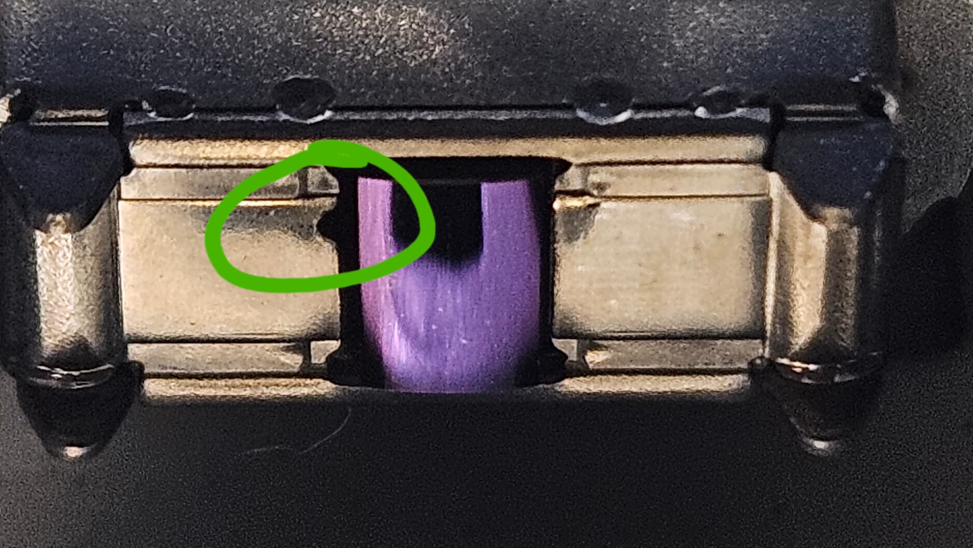

In a recent acquisition of a Philips 951, after recording a Cassete on this equipment and running the service test I found an error on CH3 (01 02 03) blinking !
Other Cassetes recorded on different equipment don’t appears this error and plays perfectly both Analog and Digital!
Also the message repeated of “clean head” and after open and cleaning the head with a Coton swab and alcohol, message disappear but error on CH3 continuous… looking on a detailed picture of head I saw this little hole in one side of head plate.
Can you suggest what happened?
Could be this the reason of CH3 errors?

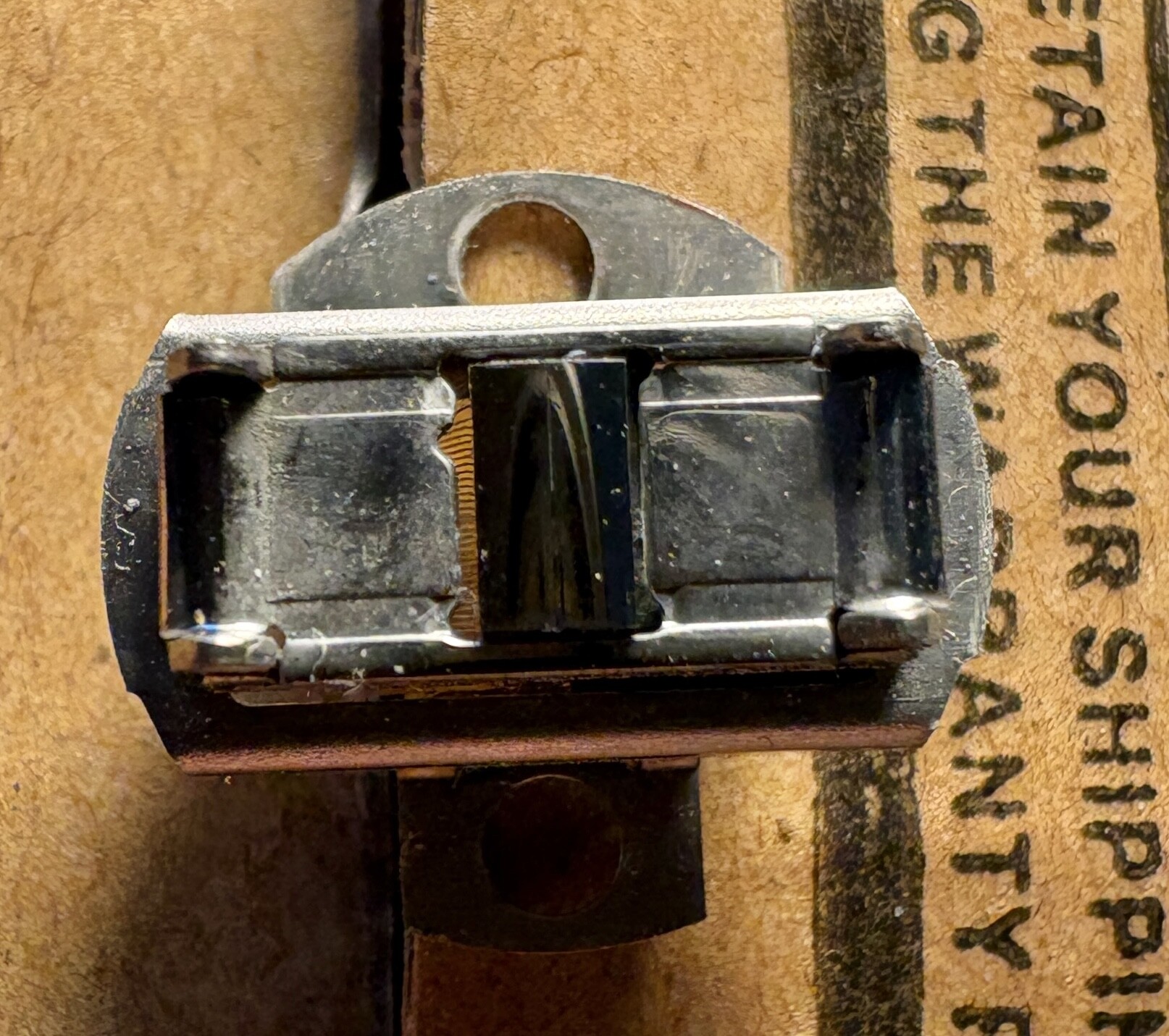

its an old Head from P 951.
Its the Same..
Thank you . Meanwhile I check other heads and gget the same conclusion that is a typical detail on all heads. The error could be related other issue.
