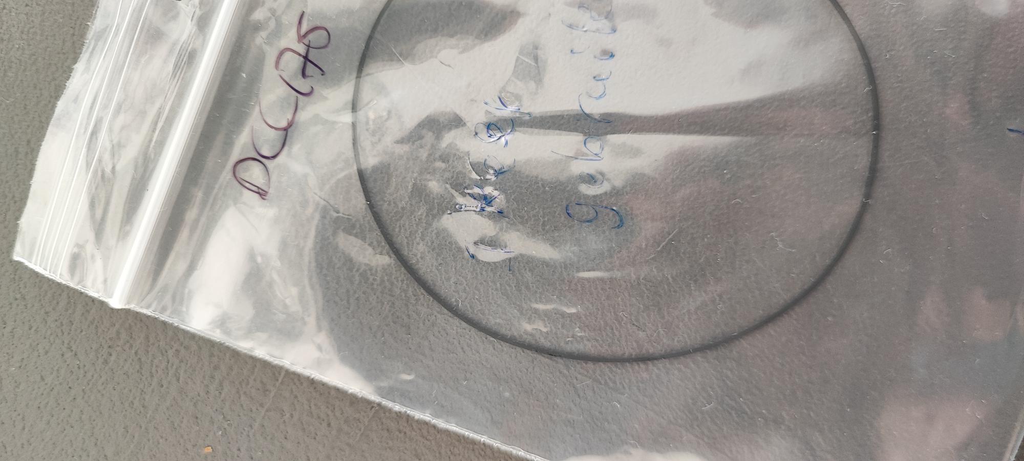

I attached a photo of the belt, just to be sure. This is the first one I used, which is the same size as the second belt that I tried, both exhibiting the same issues. I have not replaced the SMD capacitors yet. Could this problem be due to an issue in that area?

It usually is the still the belt. As the tapes age, it will be harder for a single engine player with a very thin original belt (0.6mm) to pull the older tapes during FFW and REW actions.
Some tapes have more resistance due to storage, age etc.
Most pre-recorded titles do not suffer from this, as they are mostly shorter in length.
The original 0.6 mm belt sold in various places, is often too stretchy. This means that if you put a tape in there and the problem occurs, the belt will stretch immediately and the player will stop FFW and REW at that point. The belt recovers and you can try again. But the new belt will suffer from this in my opinion.
I have ordered from several places the 0.6mm belt and all of them have the same stretch problem in a lot of mechanisms. Some might be fine, but most are not.
We used to replace the belts with 0.8mm on all portables, but last year we discovered that 0.7mm is the best size to assure results. It still might not be perfect, but with the slip mechanism (the should stop the player when rewinding to the beginning) and these problems you are having with FFW and REW, the 0.7 might be the best shot.
0.8mm will work as well but is a bit tight.
If non of these belts work, you might want to replace the engine, to see if that helps.

I am pretty sure they sold you the right size. But if you read my previous post, the right size belt is sometimes…. No longer the right size. Officially it was 0.6mm and that is what they sold you. In our opinion, this will not work in some portables. It has only partly to do with the belt (it might be more stretchable vs the original maybe), but everything with the torque needed to drive the mechanism and older tapes. For that you need a thicker belt in my opinion.
