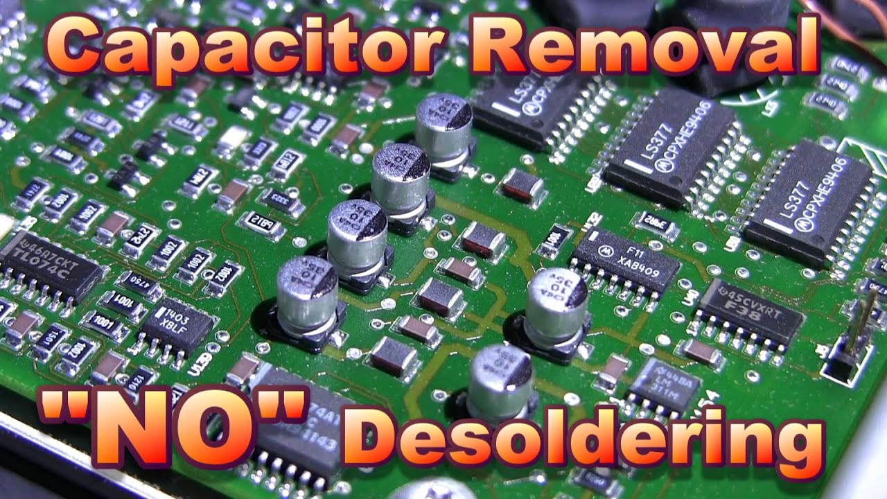

I use a similar technique to remove SMS caps, no hot air gun required:
To be honest, this seems risky to me regarding ripping of pads and replacing electrolytic capacitors with some other style of capacitor is not a wise choice unless you really understand the circuit in detail.
I find it too and use a slightly different mechanical removal method: I cut and pull carefully the aluminium cylinder with the rest, than desolder two remaining stripes from the board with the wick. This method is very quick and proven to be gentle to conductors
That is very interesting. Thanks from sharing.
I would like to discourage any first timers to cut the smd capacitors.
It will surely ruin the boards. The acid makes it vey brittle.
Slawa is a pro, but removing smd capacitors from a first gen dcc player is not easy.
Probably the board used in Mr. Carlson’s demonstration video is al lot more robust than the boards in the DCC.
