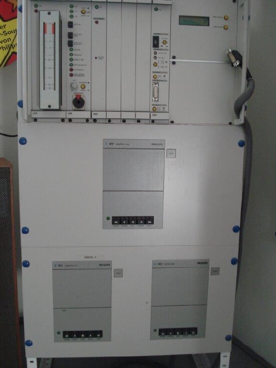

Deze foto komt oorsponkelijk van een Franstalige website:
Wow, what a machine! Still, I don’t get where it was used for… 3 players? Was it ment to produce prerecorded albums?
Big interface cable so there is more we don’t see!
Yes, we have one of the “pyramid” players at the museum, but without the main unit, it is not directly usable.
