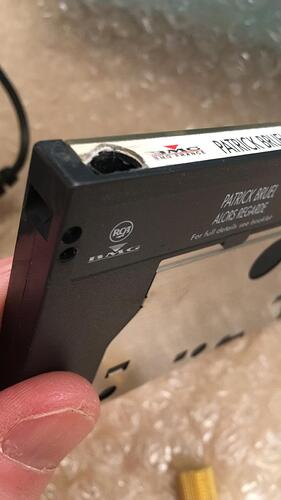

It looks like you need to drill a hole in the bottom 2mm from the edge and 8mm from the back. Note: DCC recorders ignore the notch on the edge, what matters is the holes in the bottom.
Welcome. I agree with @Max that maybe modding these tapes is not the way to go.
Either you have to drill (see horrible attachment and this is not the way to go) or mod the player. Either way it is better to sell them and get real recordables.

As I think about it more, drilling could be problematic: small particles of plastic could/would be floating around the inside of the cassette, resulting in possible damage to the tape, or worse, the all important R/W head !!!
Unlike the old analogue compact-cassette, there are no screws to dismantle the case (at least not in my tapes) to help open and clean out swarf, or to remove the tape reels before drilling.
I’m guessing the DCC cassettes clip together somehow, or worse, glued or ultrasonically welded ? This all poses issues with drilling holes, etc…
