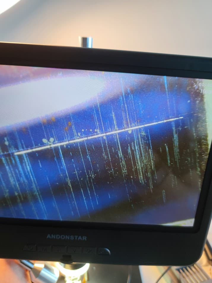

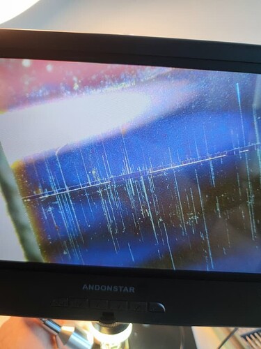

Third one was DCC730 sold as faulty for 50$ - it was again a mistake buying this - total crap, the head had major scratches on it, one digital channel is blind, so playback worked unreliably - unusable.
