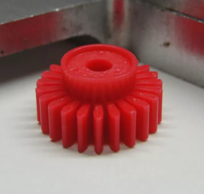

Be careful. Some of the sellers use improper packing and some sell parts with wrong inner diameter. I had both. Best results with red polish part.. Carefully packed and best fit. I woud recommend these.

I got the gear on eBay from Poland. The quality is excellent and the recorder is running smooth again.

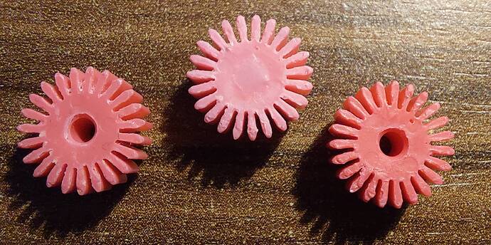

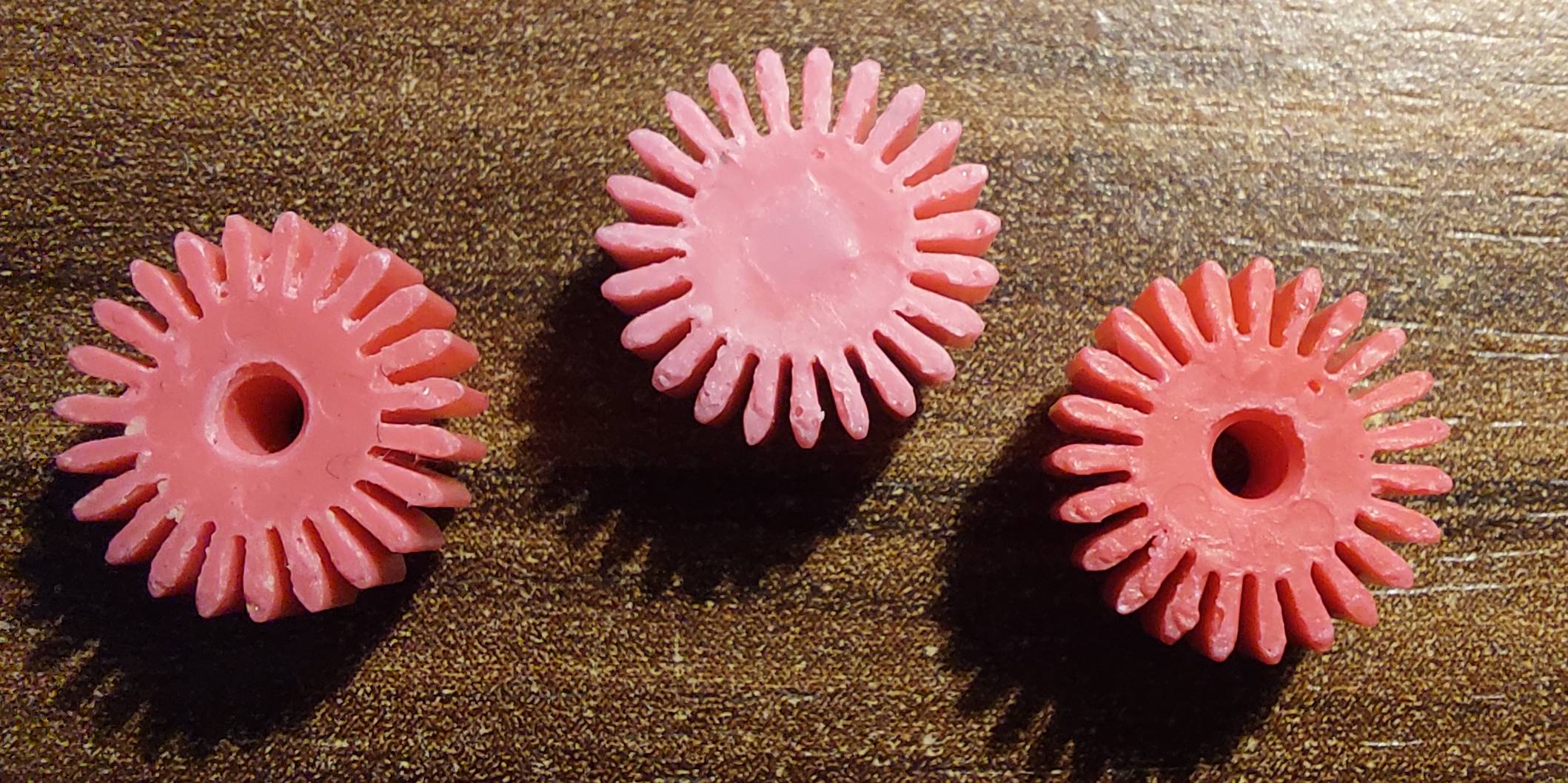

I’ve got very bad experience with red gears from Poland, three times in a row. The gears were not finished smoothly and I had to do this by hand. Furthermore they looked bad overall.
I’ve added a picture, so you can see for yourself.
Seller sold better gears in the past, but this was a year ago.

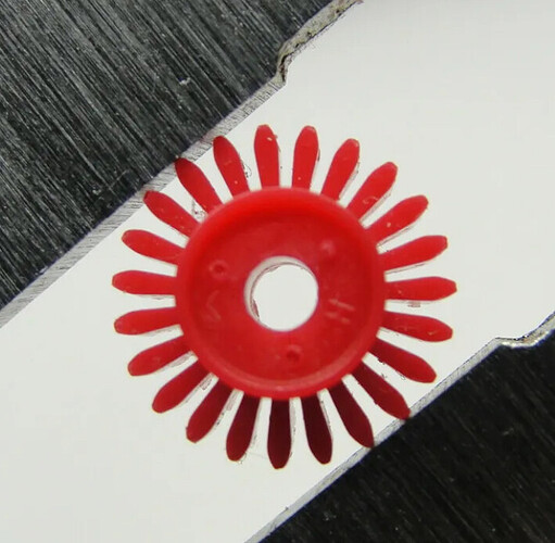

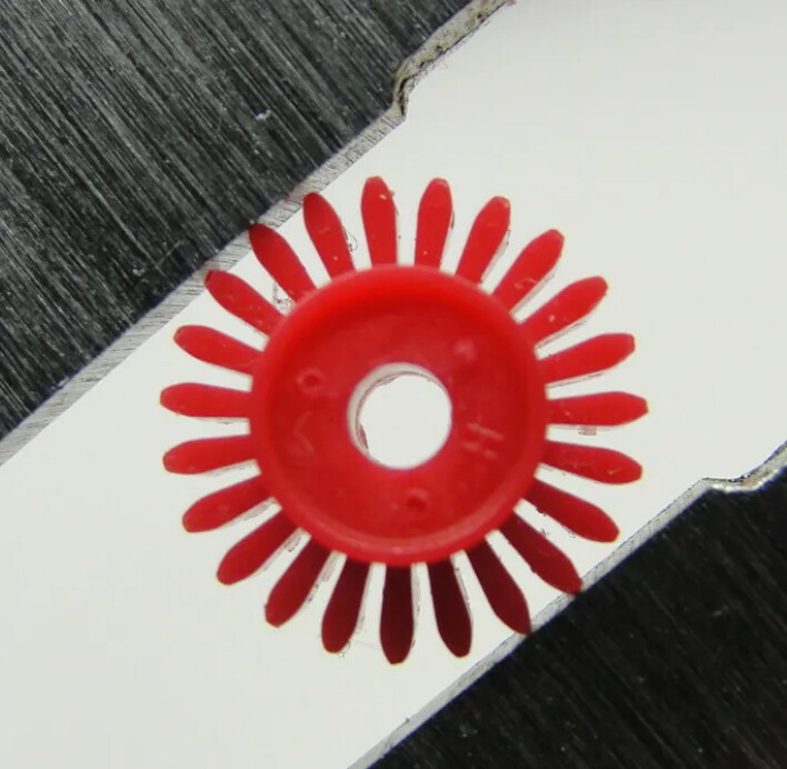

The gear from Poland. Pictures from eBay but gear looks identical.
Yes, it’s the same apple guy :wink:

After a month of use, the gear is broken. One of the teeth has broken off. Luckily, I still had the old gear. Super glue works wonders.
