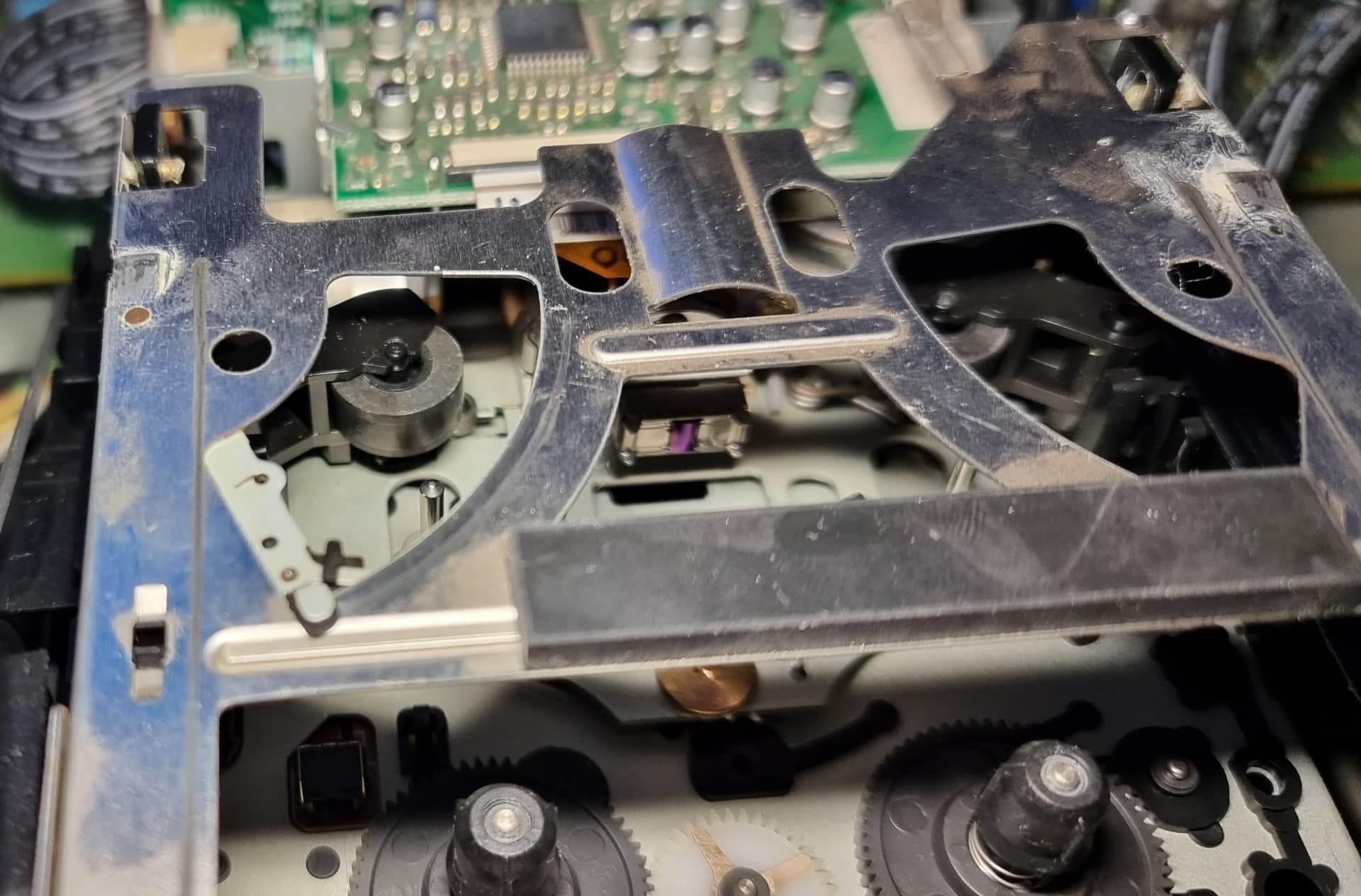

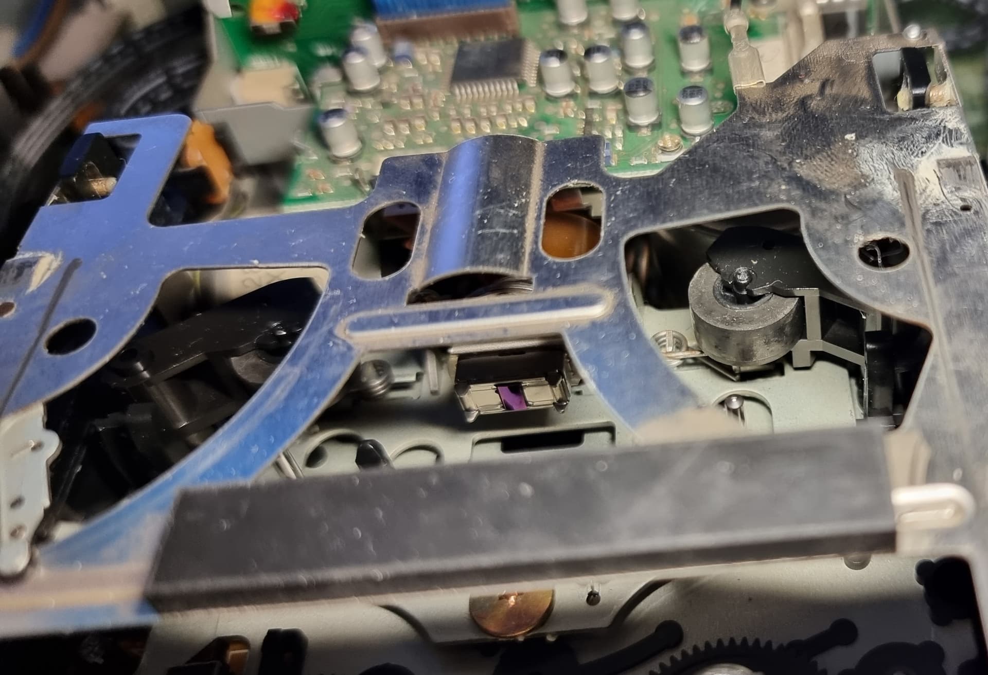

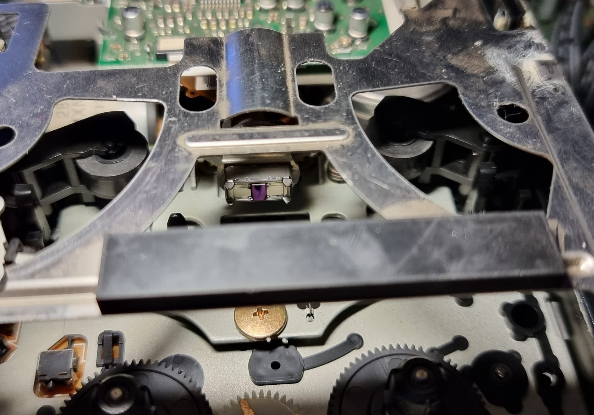

Can you share a photo of the mechanism? You can upload pictures directly here without the use of any 3rd party service.

Here are photos.
It is most likely the pinch rollers, or the tapes (Felt pad issues). The felt pads can dry out, causing problems just on one side. Even new, first generation tapes suffer from this.
Please replace the pinch rollers first. In my opinion 100% pinch roller problem. They look very worn.

that right pinch roller looks gone.
