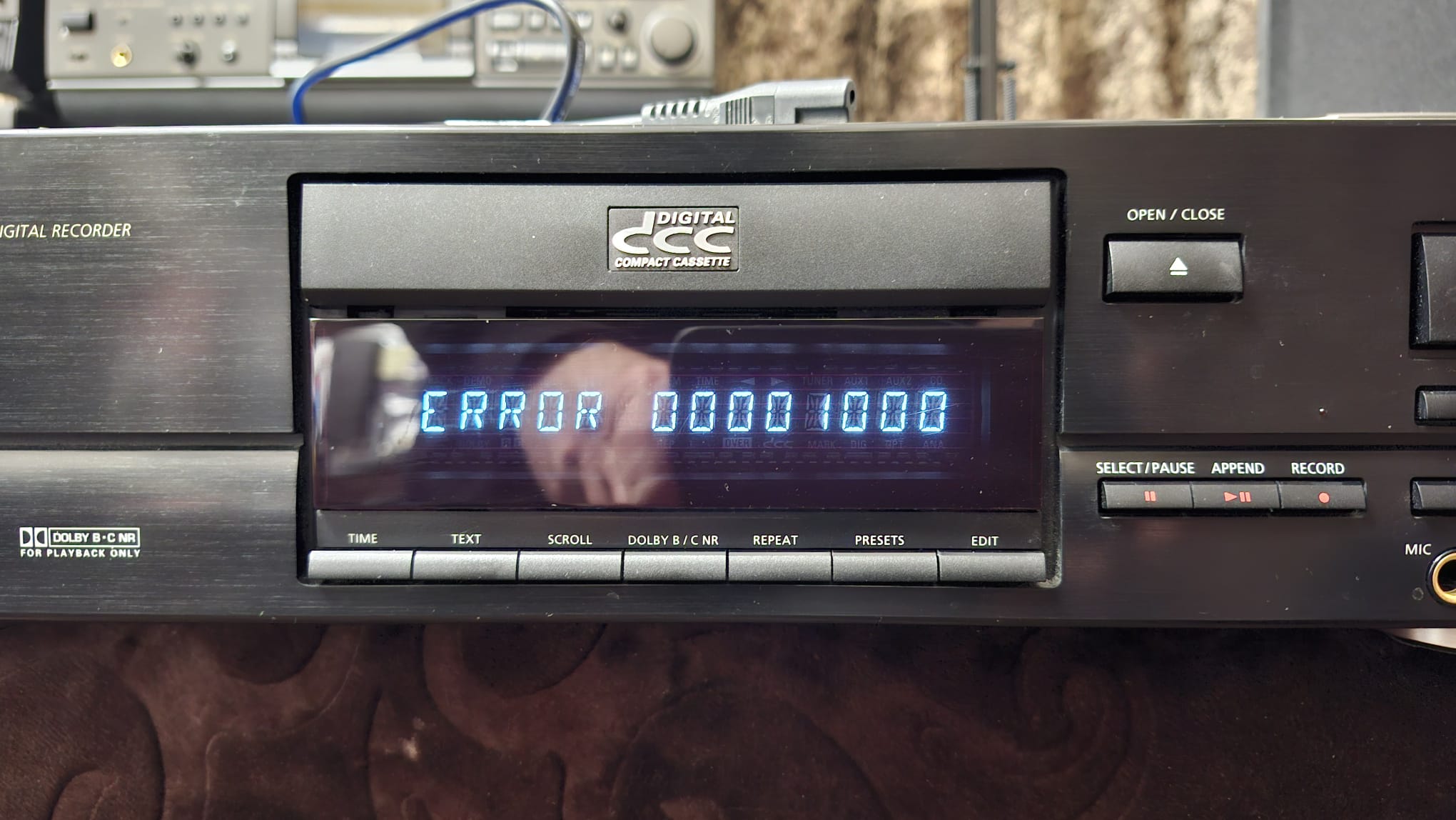

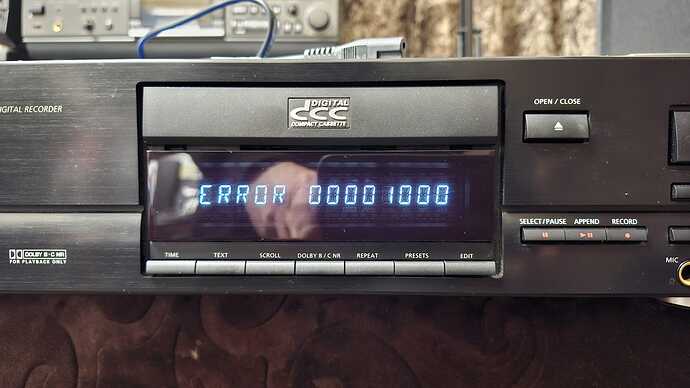

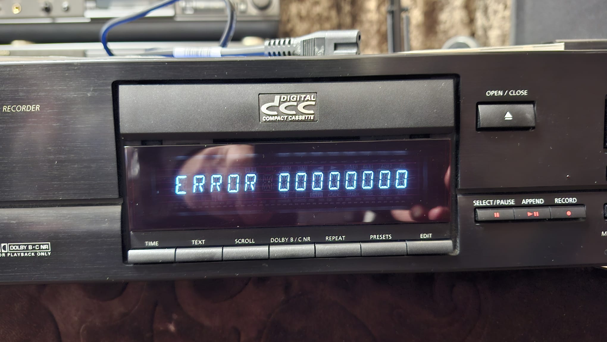

Take a prerecorded tape. In normal play mode, fast forward to the end and go back a minute or two. Power off and put the deck in service mode. Play to the end and let the player switch to side B and let it run.
What does the service mode tell you about the head errors when playing side B?
I wonder if many people know about this trick :wink:
Thanks for the advice, I will do this today and let you know the result.
Side A
Side B
It might be a (little) misalignement of the head. Before you start adjusting, be sure there’s no dirt in the head’s rotating mechanism.
Before adjusting, mark the screws on the head, so you can remember their original position.
While playing in service mode on the B-side, adjust the head little by little.
First adjust one screw at a time up and down. Then adjust for both screws at the same time, up and down. During adjustment, see if the error goes away, or more ‘1’ errors appear.
Because the Azimuth Locking Pins on the head will compensate for misalignment, you might not notice slight differences immediately. Be careful to not damage your tape.
If the above does not improve the reading for head 5, it could also be a back tension issue. I have no advice on that, other then using an analog cassette back tension tester.
Good luck!
