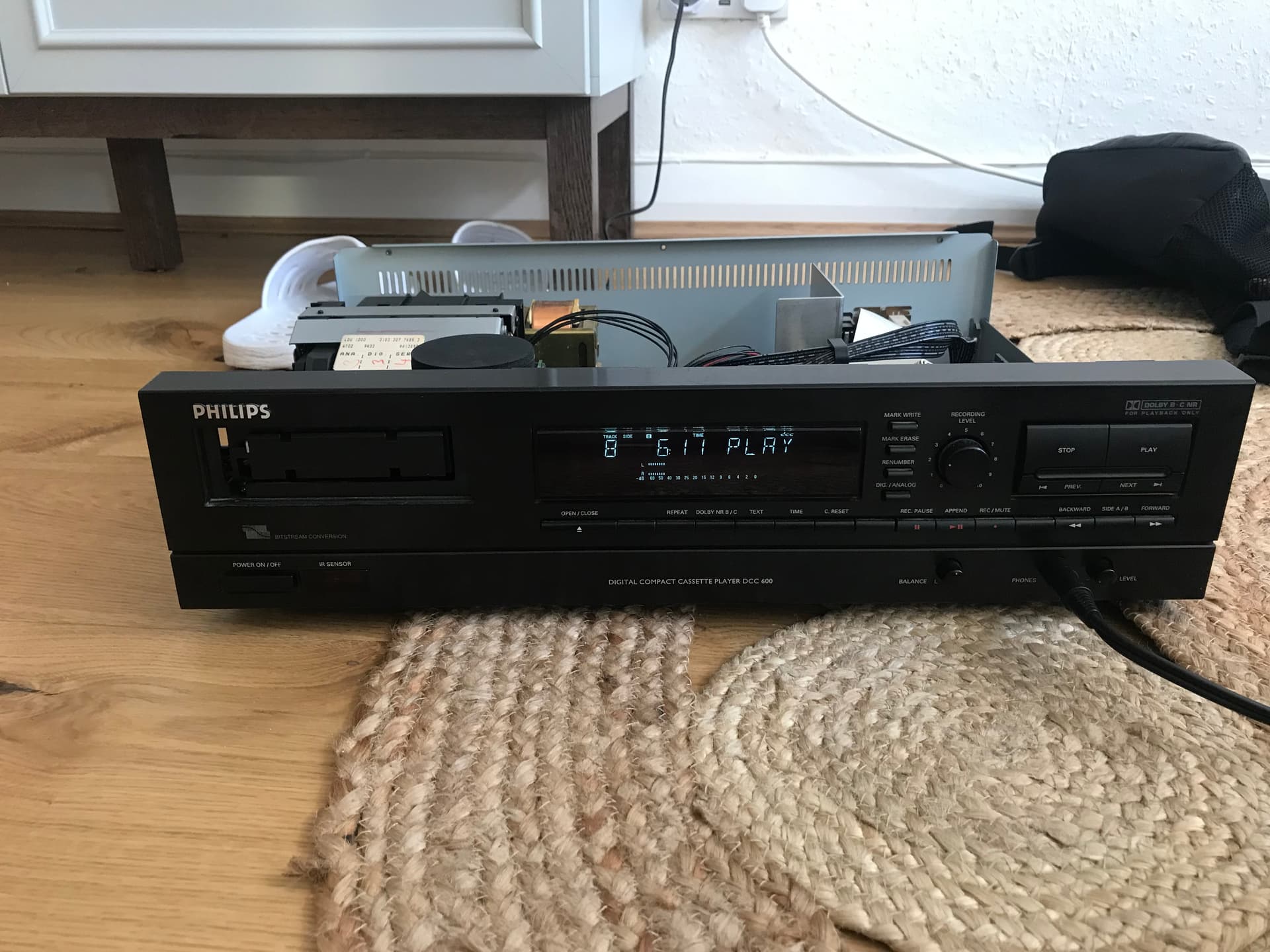

im a little disapointed with my philips dcc 600 deck, i have a lot of problem since i bought it (for parts) and i though i could fix it.
but its not !!
the problems are exactly the same after i buy new and replace captsan belt and spider gear (the silicon’s one wich can be slightly bent !!)
for a ACC, the play or the rewind or the forward of the ACC works during 0.5s and stop immediatly !!
Then the player plays ACC fine during 0.5s, not more !!
for the DCC, immediatly after the close of the tray, the head plays the dcc to read indormation, stop, reverse, plays the other side to read information and stop. (i dont understand why the dcc have to read the two sides, its not logic!!). After that, the play or the rewind or the forward of the DCC works during 0.5s and stop immediatly !!
Then the player plays DCC fine during 0.5s, not more !!
have you got any suggestion cause i dont know what to do???
thanx a lot
Change both the pinch rollers.
Take an ACC cassette and check for rotation of both reels. If that’s ok, check the spindle sensor (and signal path).
HI and thank you for your answers!
I found the solution !!

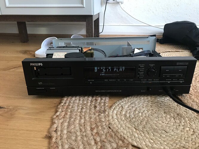

I extract the tape transport part from the tray part, i tried to play ACC and DCC without the tray part (but still powered) directly on the tape transport part, and put finger on ACC and DCC to have enough pressure and its works fine !!
the issue was a default on the tray part, the cassette wont load correctly on the tape transport and the deck wont play anything!!
I fix it in slightly bending the 2 metalic parts in front and behind the drive unit and its works!!
My dcc deck have new belt and new spider gear, and works fine !!
thanx a lot !!
