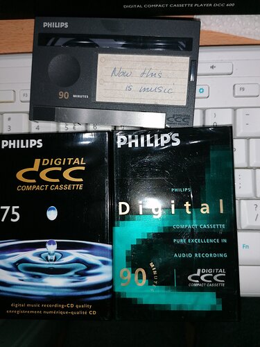

Wich dcc tape should a use? I have 5 used ones and 6 new ones. All Philips brand. I will add a piciture of it.

I am on the road, but you can download the service manual from our website to learn about these numbers. The “blue drop” tape is usually the best.
