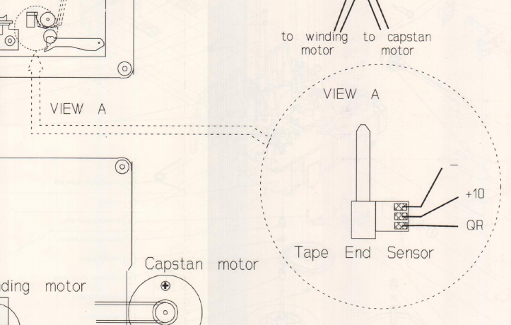

@ivanr, I am doing this from memory, so …
I don’t know how for you have ever disassembled a LDU1000 mechanism, but deep inside there are 2 discs with alternating reflective/non-reflective patterns, or also it could be like toes or teeth sticking out, attached to the each carrier, that are used in combination with a photo/optic-electric sensor to detect the correct tape motion in every possible mode of operation.
If one of those sensors malfunctions, or gives somehow the wrong information to the logic circuitry that is controlling the tape-operation, the deck will STOP.
It could be a simple clean of the sensors. Or a re-align of the sensors if they do not detect the correct light-no light sequence that they expect at that moment.
Or it could have something to do with this:
Page 62 (36) of the SM.
Good luck!
