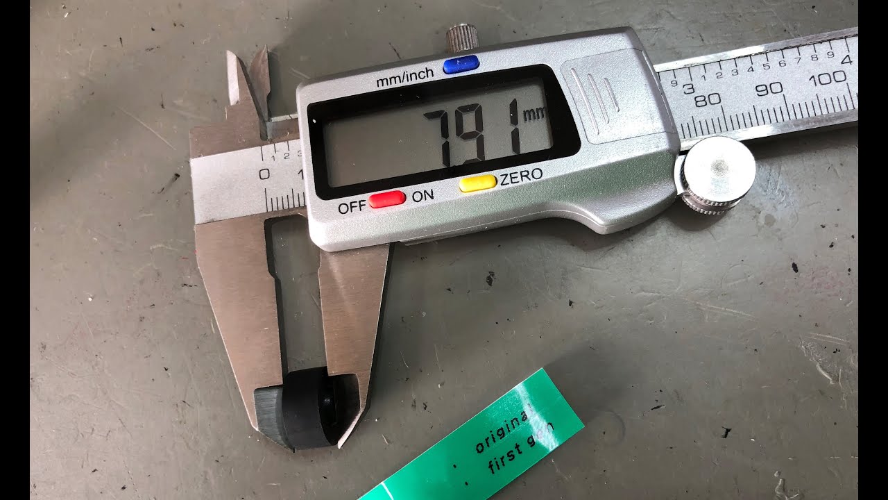

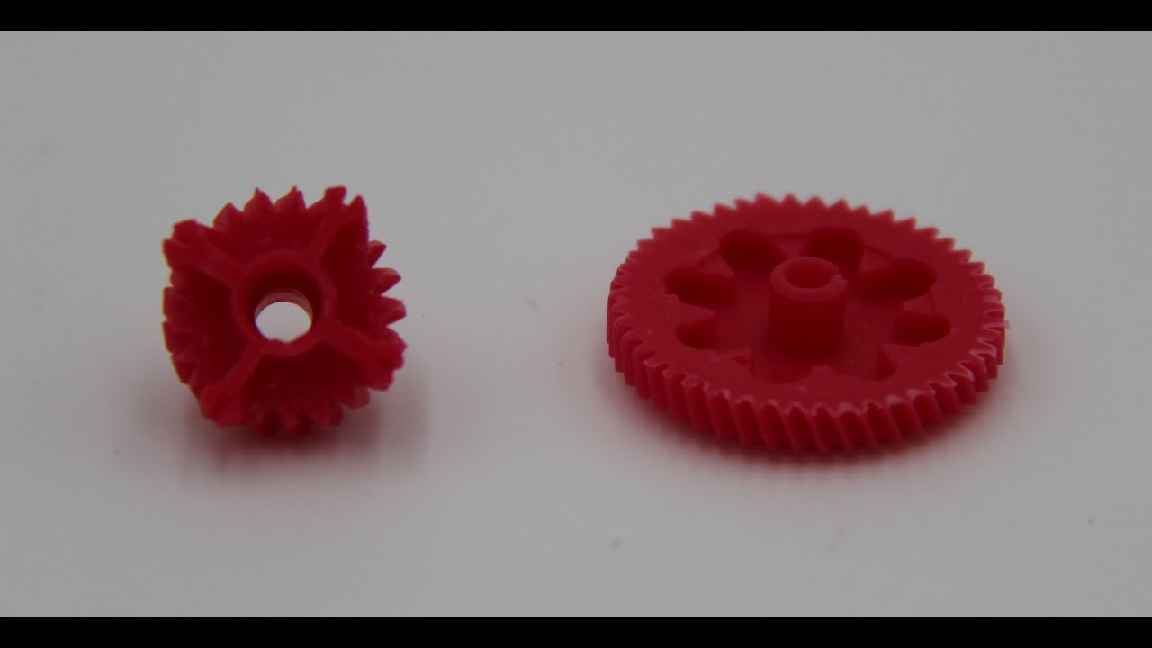

This video covers it:
In this video, you can see it as well.
The block is removed just before getting to the gears.
It has the head, pinch rollers and read-write board attached.
You can move this over to the mech that works.
It should work.
