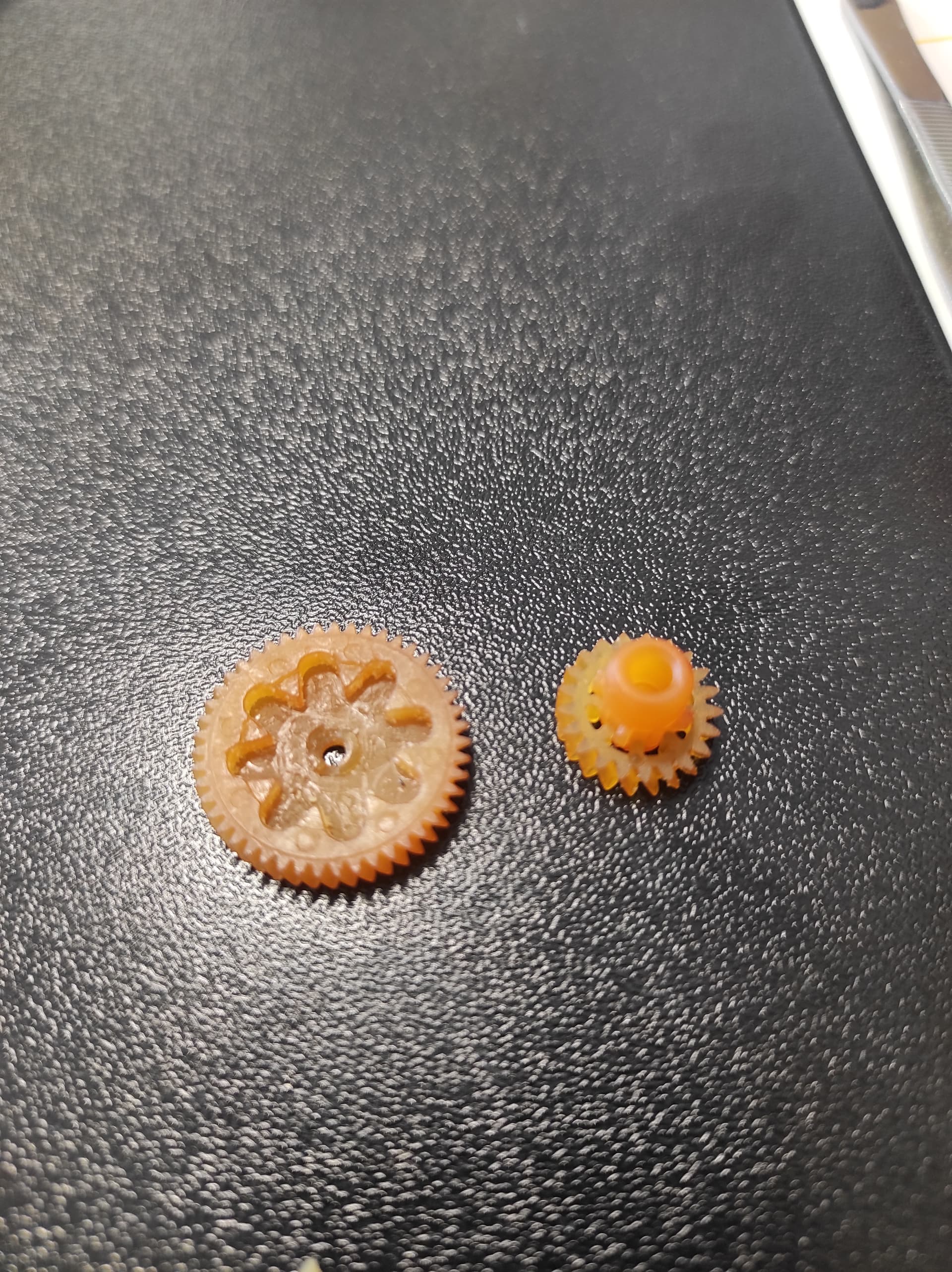

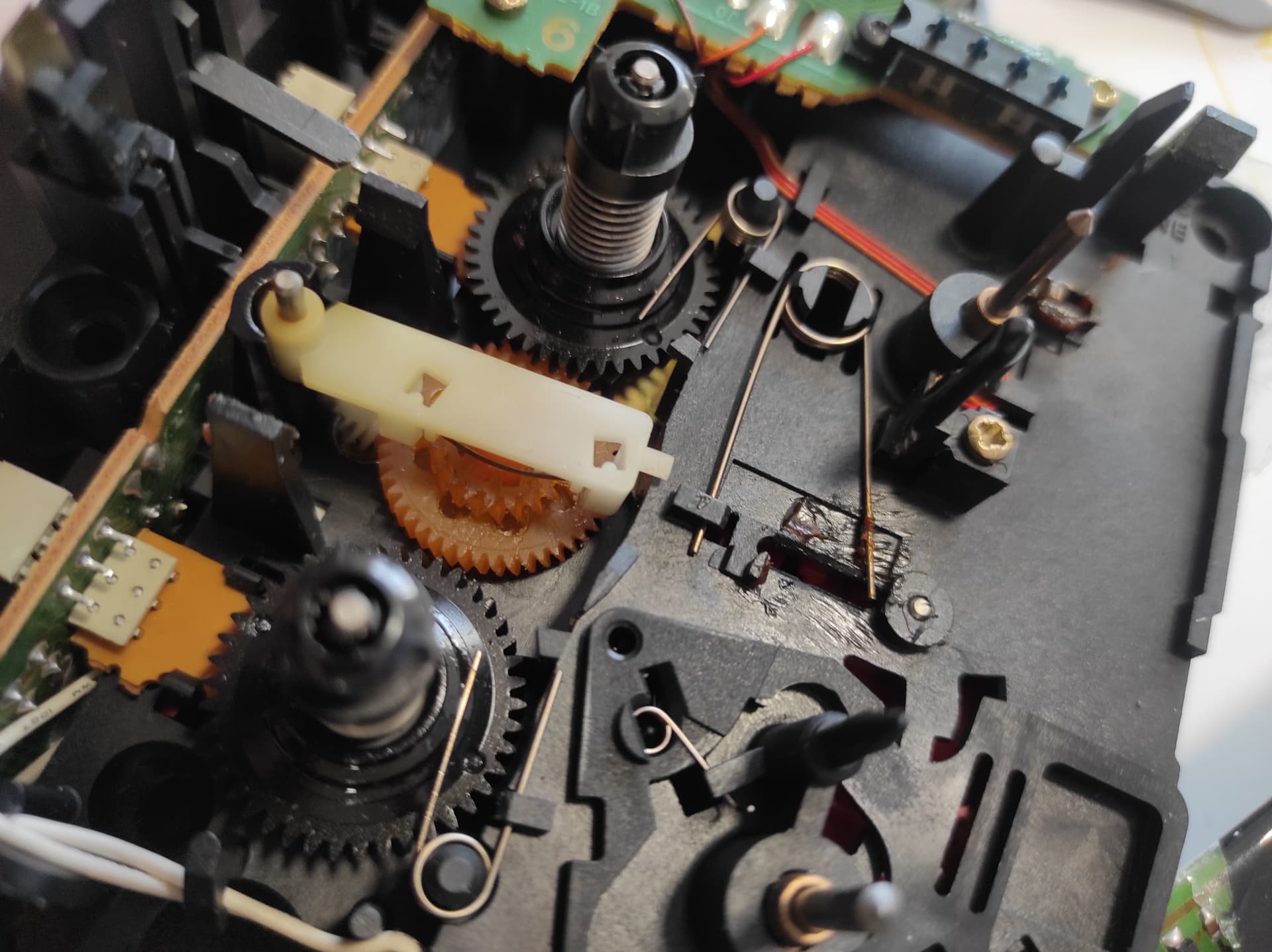

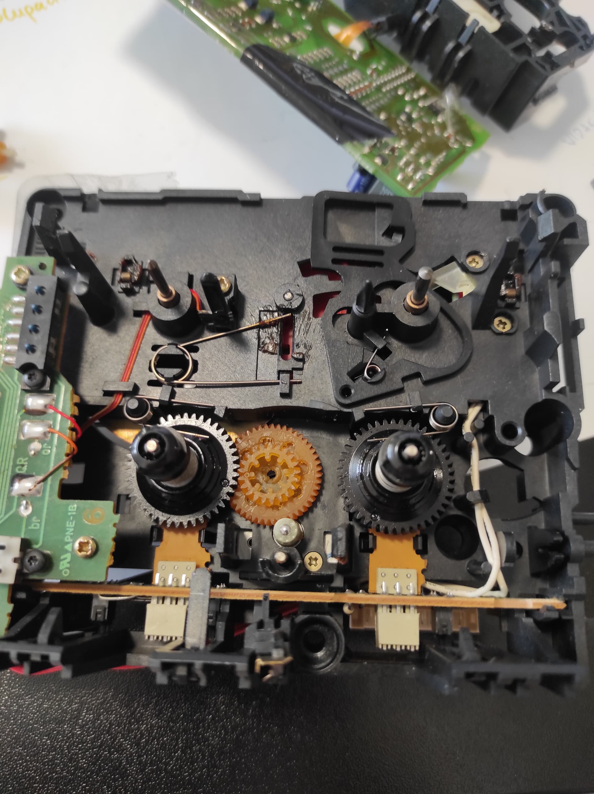

First check rubber belts tension and orange gear for transport…
U must dismount a tape mechanic to see. First try manual loading with… Finger… With analog tape- cassette. If hear noise or crackig sounds..gear is broken …and for tray belt you must put a new one.
