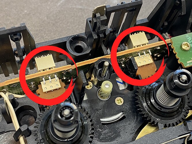

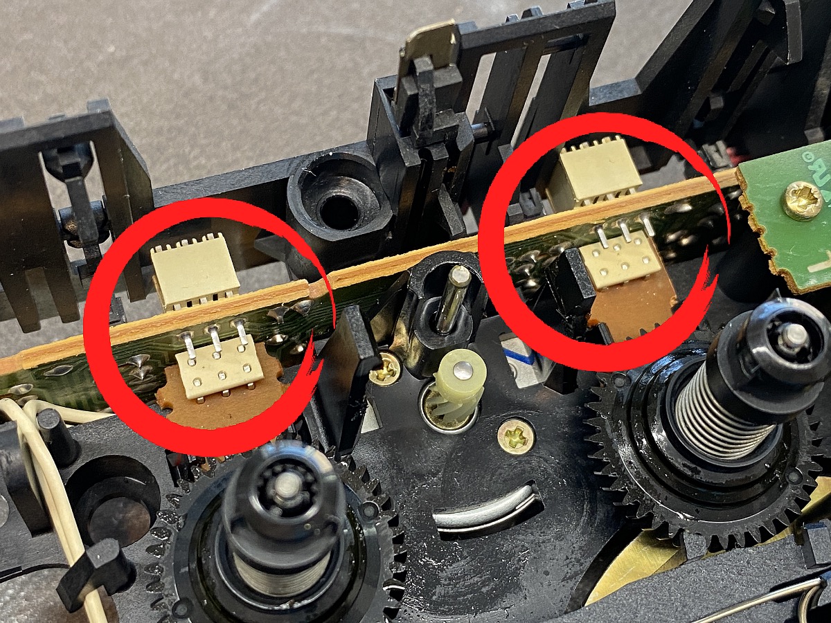

Ralph sent me belts gears, rollers and yesterday I took the whole thing apart and changed the lot to no avail.
Tray doesn’t work at all - When I manually wind a tape in it makes a very short attempt to drive the spindle - with the mech out I can see the new gear wizz about and then it stops.
The deck has been taken apart plenty of times but the mechanism hadn’t been taken apart down to replacement gear level as the three long screws look brand new. The old gear looked fine as did the old belts - Rollers looked a bit grotty though.
Unknowns -
The large red gear (under the tape drive belt) with the yellowed plastic arm - how should I have it positioned before reassembly?
The head mechanism seems free to move in and out but when I press play It doesn’t move. No tape comes out of the cassette.
I took the two capstans out - They fell apart and I’m pretty sure I’ve put the one back fine as it’s a nylon sleeve brass-like end - The other one the sleeve goes into a recess and locks (it’s a square both ends?) then washer then brass-like end.
Seems like a power problem to me - I might power the motors to see if they run. Perhaps the previous owner has removed a cable or something (I don’t think so though as I’ve watched enough videos to be quite familiar with what should be in there)
