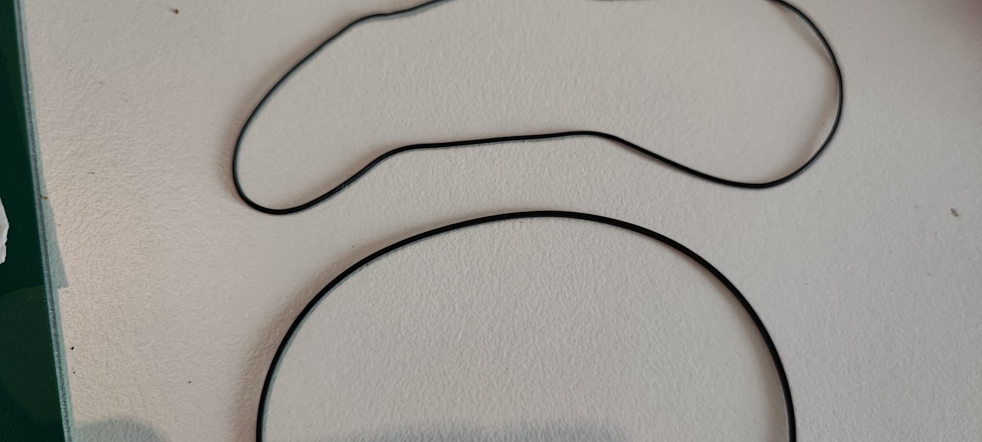

Old belt and new belt. It looks indeed thinner than the new one.

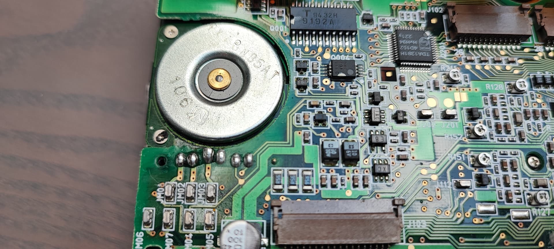

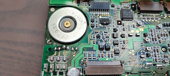

It was my first micro soldering project but it went fine. I hope you like my first soldering experience. :grin:

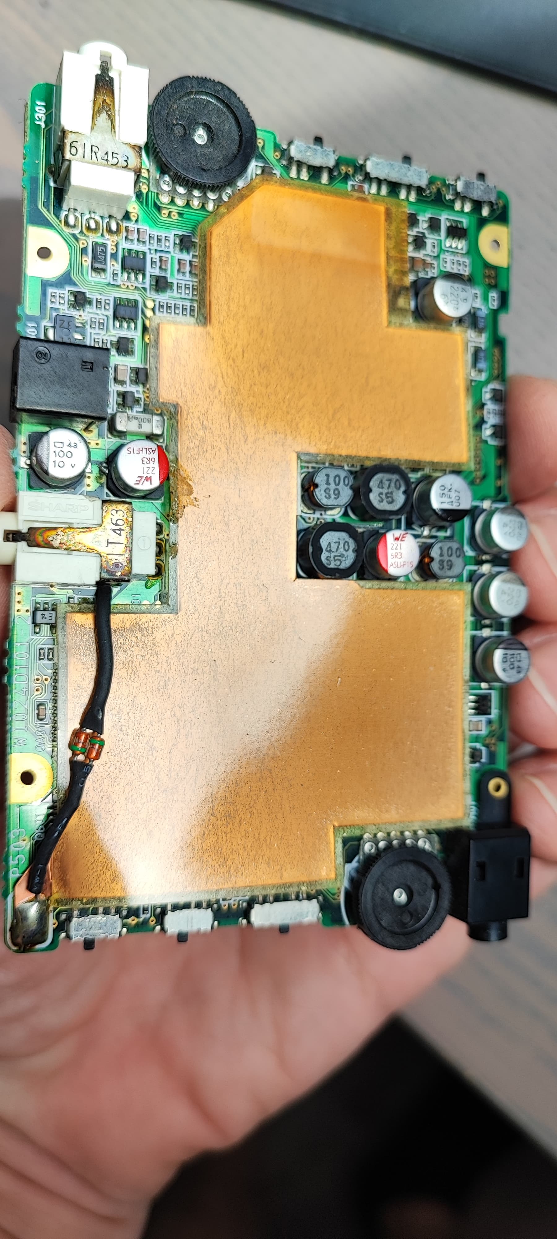

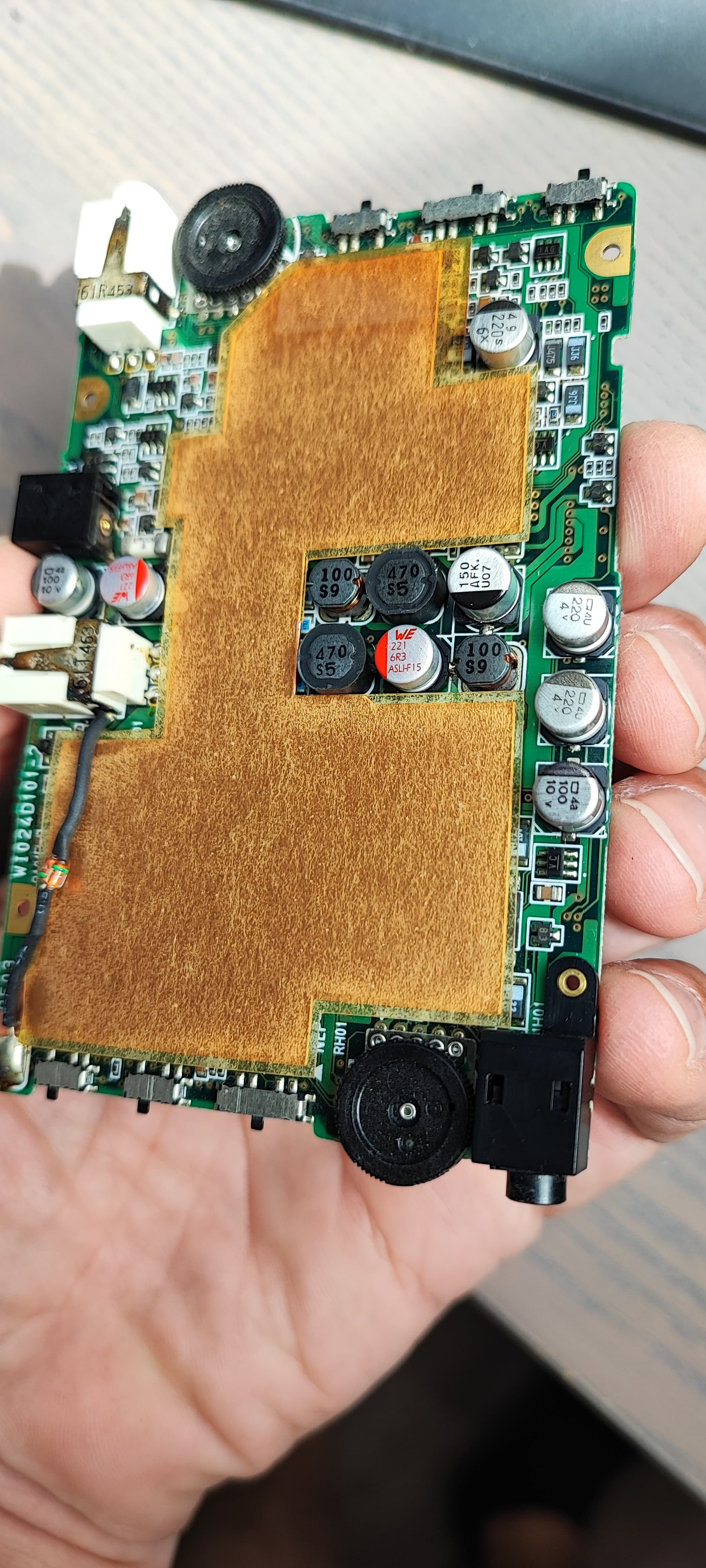

I have a question about the replacement of the SMC capacitors which was done by the seller he told me two years ago. Can you tell me if the capacitors are indeed replaced with new ones, cause to me it looks like they are factory soldered.
Thanks for helping out.
Looking at the pictures, it looks like only a few are replaced.
I would redo them, as this is very strange.
Am i right that only the two red caps looks like they were replaced?
That is what it looks like indeed.
