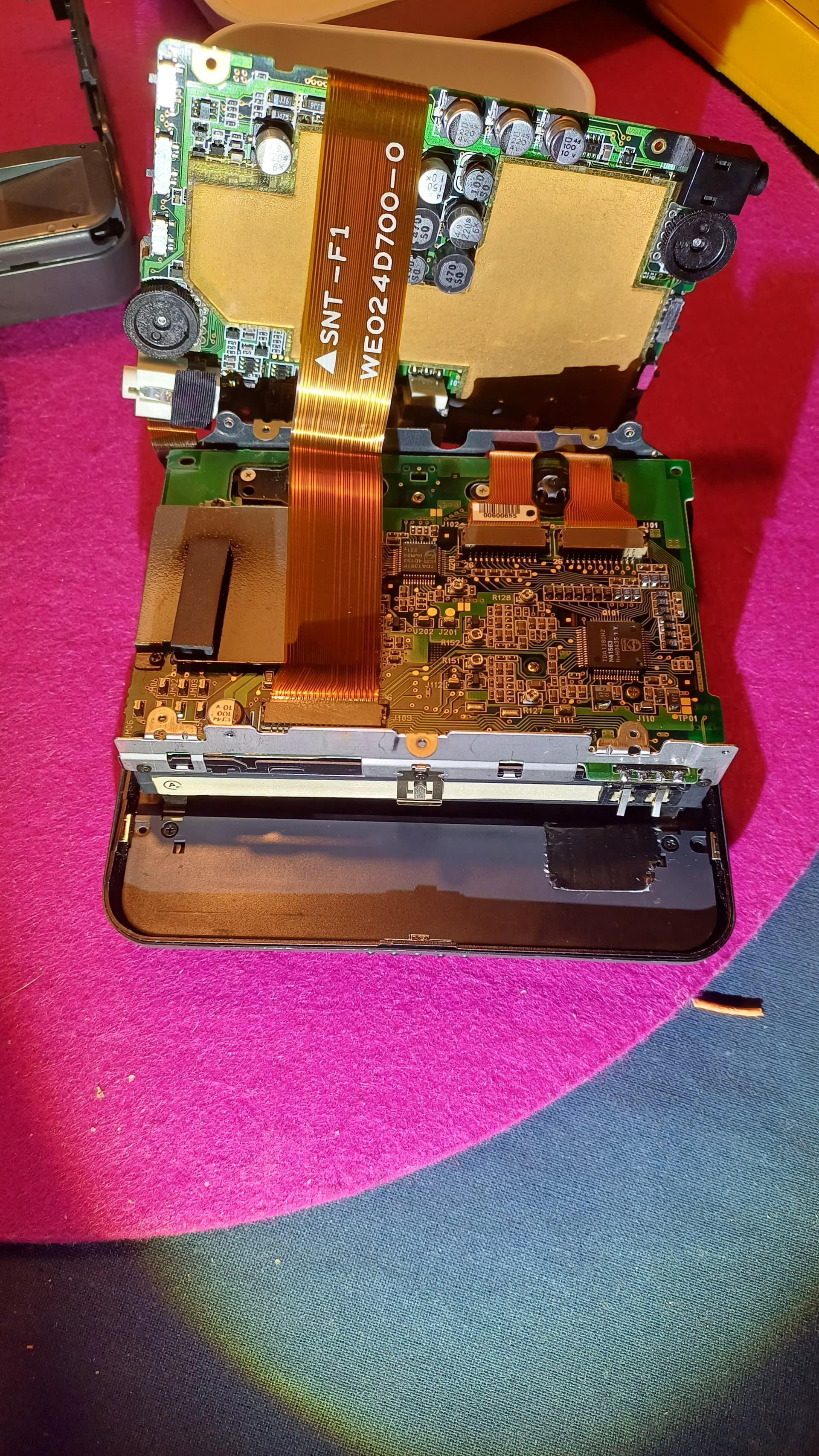

First i worked fine, but a few days later it did not turn on at all. Until i took the higher board out to check belt, fuse, etc, then it suddently started working on test while partly dissasemled. When i put i together it did not work again. Status is that theres no light or movement. Have top board out again but i cant see anything obvious. Do i have to send it all the way to california or do i have other options of faults to check?

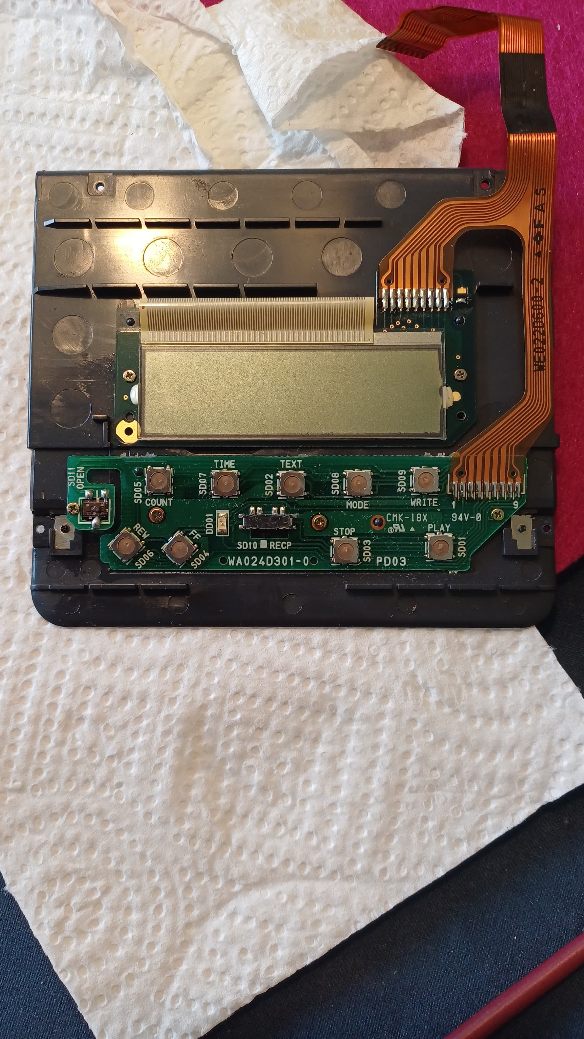

It reacts when testing continuity. Unfortunally still no progress. You say bridge all four pins on the tape contacts with a hair of wire
Taped the lid sensor after controlling continuety. Bridged four tapesensor pins. Stil no life unfortunally.
This indicates a electronic problem in one of the boards.
Check the fuse to be sure.

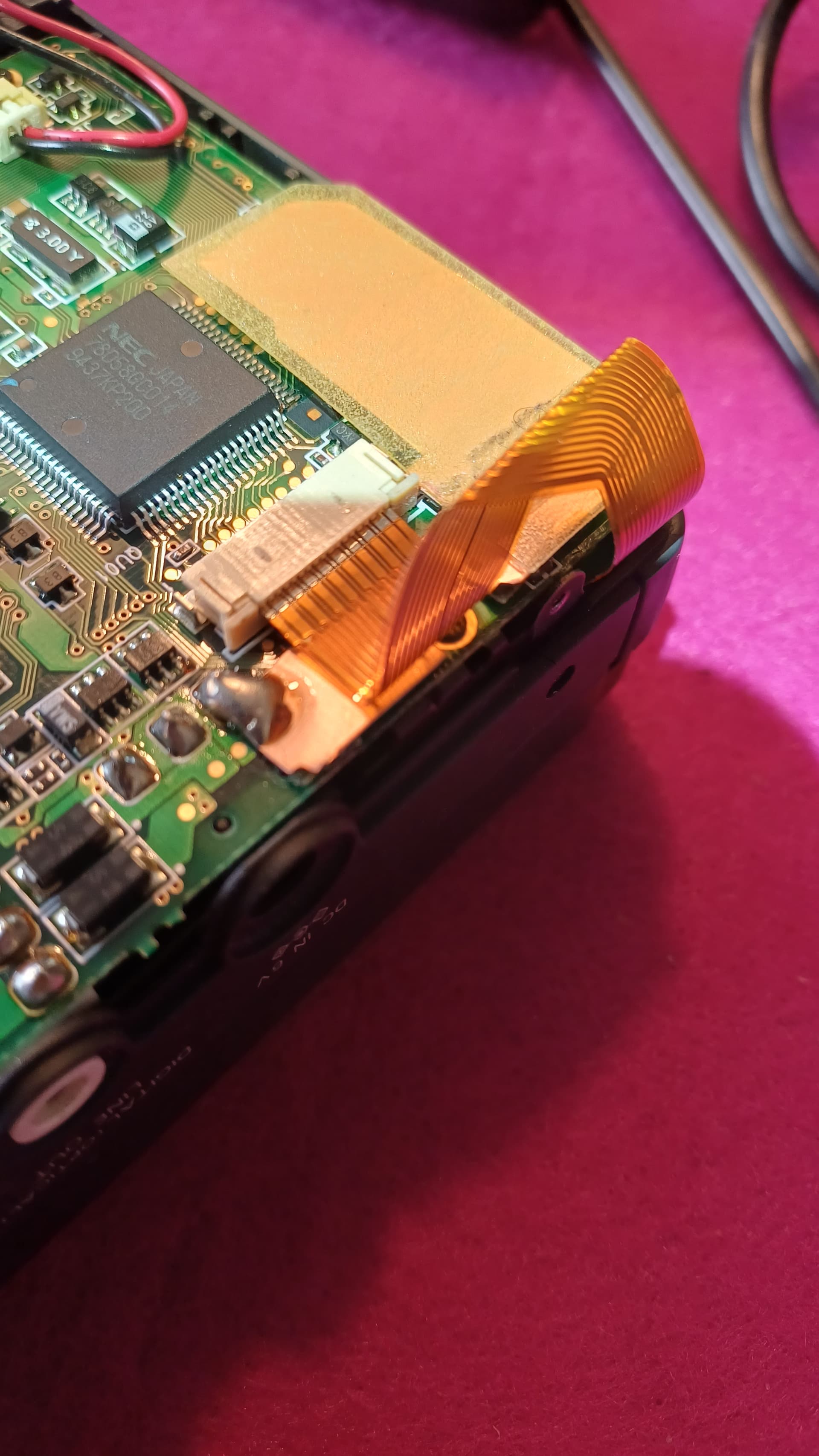

I have now checked the fuse. It seems ok when checking coninuety with a multimeter. What would happen if the ribboncable to the display and buttons is defect? Are they known to be fragile? It seems pretty bend.
Hi, That seems pretty normal to me. However if the cable is broken, the player might not start.

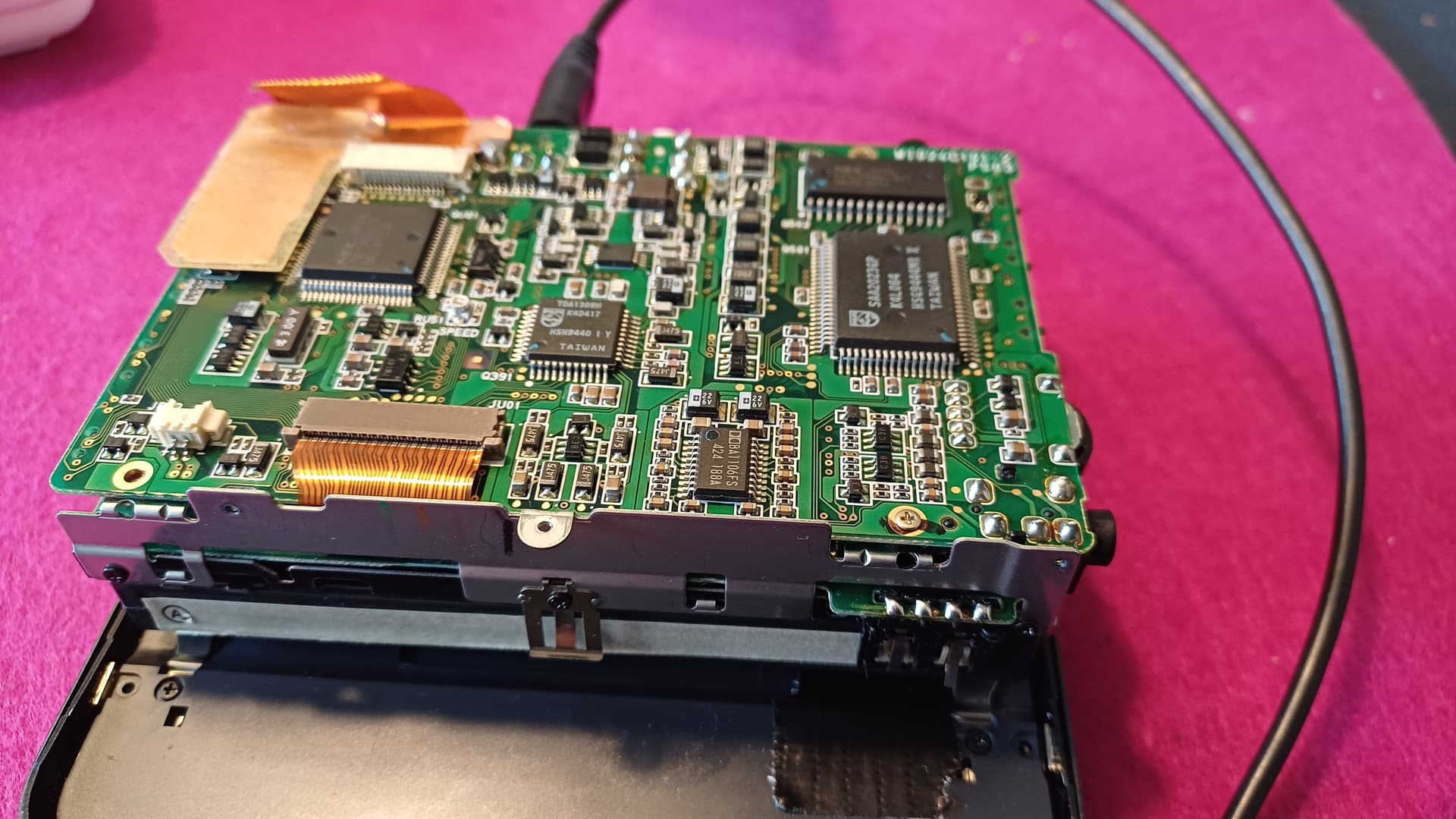

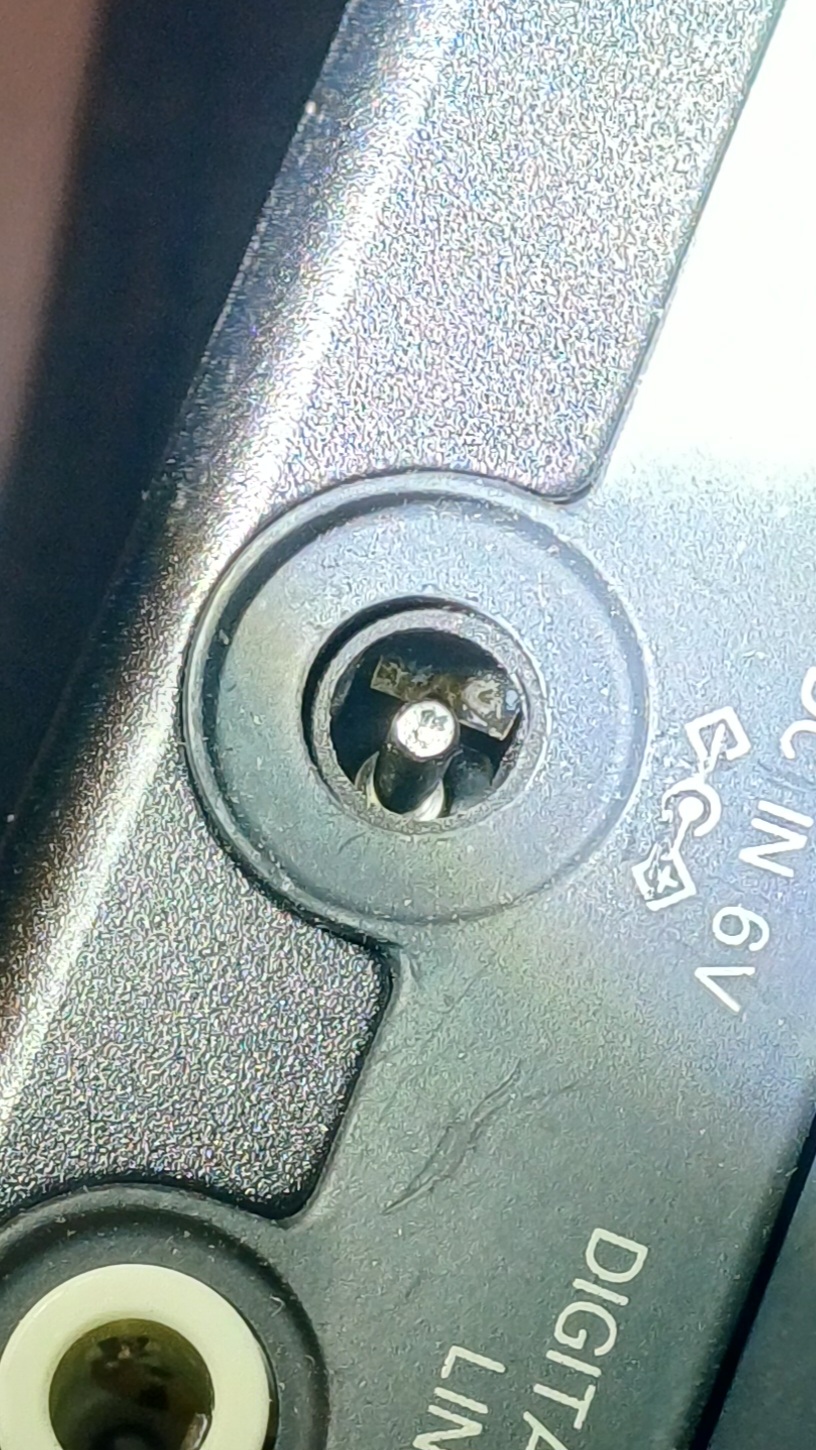

Hi again, its been a while, but theres a new development. I dicided to try a new trick i heard of by heating the device gently with a hairdrier to try to revive capasitors in an old vcr. (Worked!)As i tried it with the dcc170 it actually turned on and worked. Unfurtunally only for a few minuttes though. I was able to do this again after putting it in the freezer for maybe 20 minutes. Al though its still not working, i have a little more hope. I also discovered some sort of corrosion in the power barrel plug i have missed seeing earlier. Looks a little like leaked batteries do.
I had two of the dcc 170 in my collection with the same error. I had to replace all the aluminium electrrolytics on the upper board and one on the lower board. I used tantalum caps. After replacing the 170 started again. I bet this will be the same with yours and you can remove the former switch mods. The cooling behaiviour is another strong hint for this error exept there is a solder trace brokien from bending.
