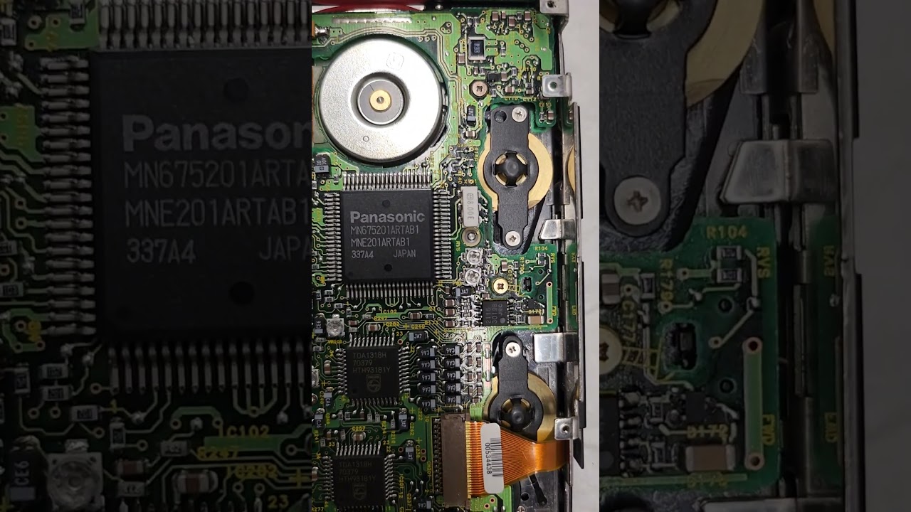

A few weeks ago I bought a DCC 130. There was a lot to fix (new caps, new belt, broken pcb tracks, wrong screws etc) but one problem remained - there is no “fast forward” and “track search forward”. The other functions “play”, “rewind”, “track search back” are working well.
As I have a lot of donor parts, I changed the motor unit and the motor driver board - unfortunately without sucess.
If you press “FFW” oder “track search forward” the player goes back a few seconds and after two seconds the player switches to side B and then it changes the directions to rewind. I have not seen any blocking in the mechanism.
You can see it in the video
