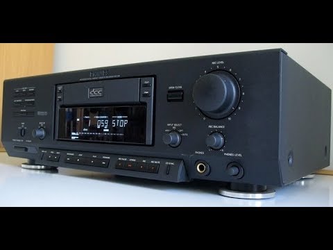

Since this morning things are going worse concerten self recorded dcc tapes. My DCC player gives no sound anymore with cassettes thata gave a untill this morning a perfect playback sound. One tape gives a very disturbed sound. Pre- recorded dcc tapes play well This playback problems occur with all tapes I recorded from cd’s myself.
DCC900, like all 1st generation DCC recorders, have a severe problem with the capacitors. They always need to be replaced. If this was never done on your machine, you should unplug it right now and replace the capacitors or let someone replace them:
