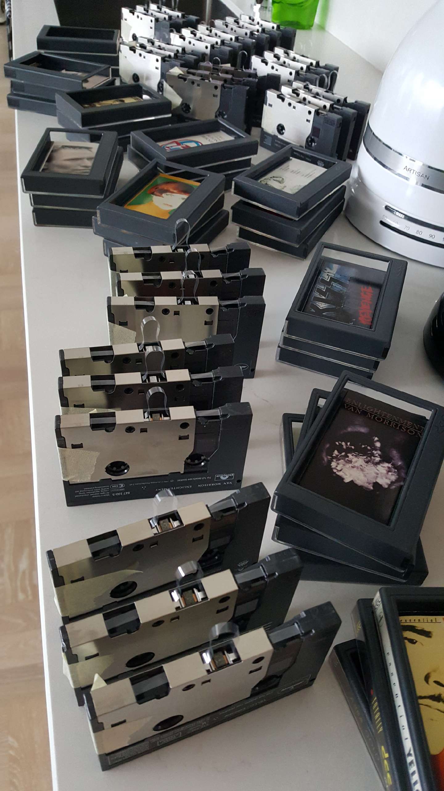

I have tried several tapes now that suffers from severe drop-outs on all three 951 players.
All of the tapes play without any issues on all my three 300 players.
I guess I’ll just have to face it..
The 951’s are more sensitive to damaged tapes.

Yes this was truly a “dull” moment as I’ve up til now believed that my collection of DCC tapes were in pretty good condition overall, as playing them in my 300 players didn’t gave many errors or drop-outs.
Of course a couple of my tapes were pretty bad even with the 300 players.
But as I’ve now got my three 951 units in playable state it became clear that my tapes are far worse than I first believed.
Of course I can still choose to play them in my 300 players for a more hassle-free listening.
