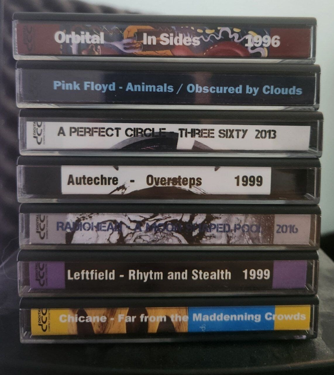

And here’s the partial result of this obsolete piracy, with printed labels to look nice on a cassette stand.
