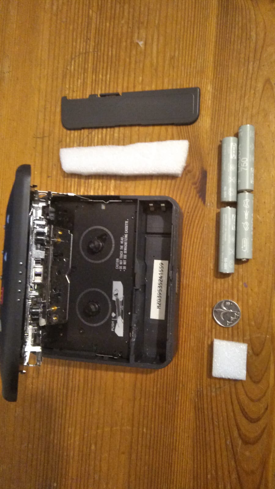

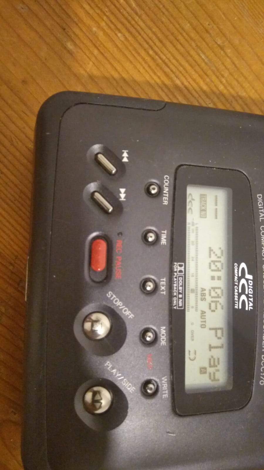

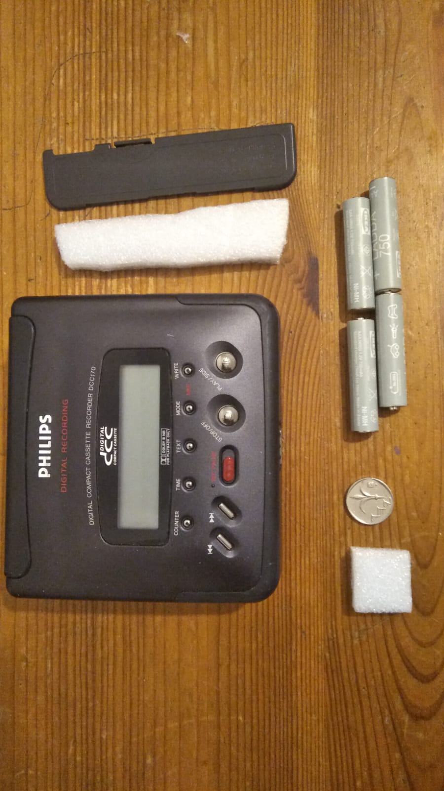

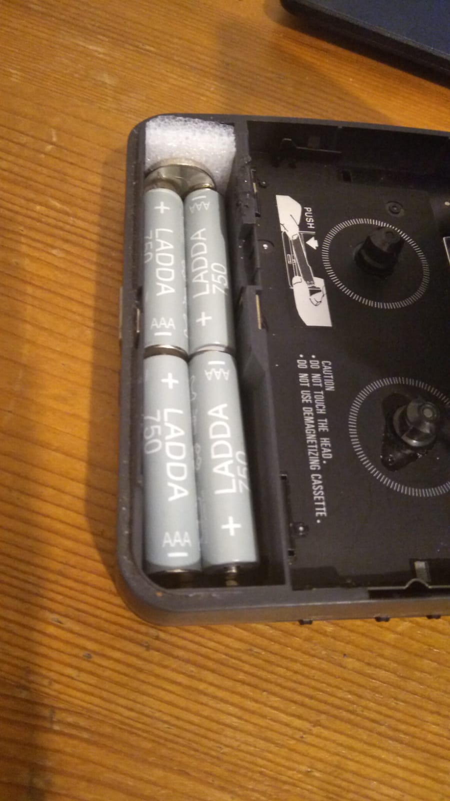

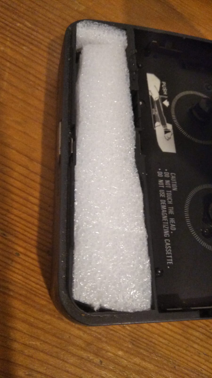

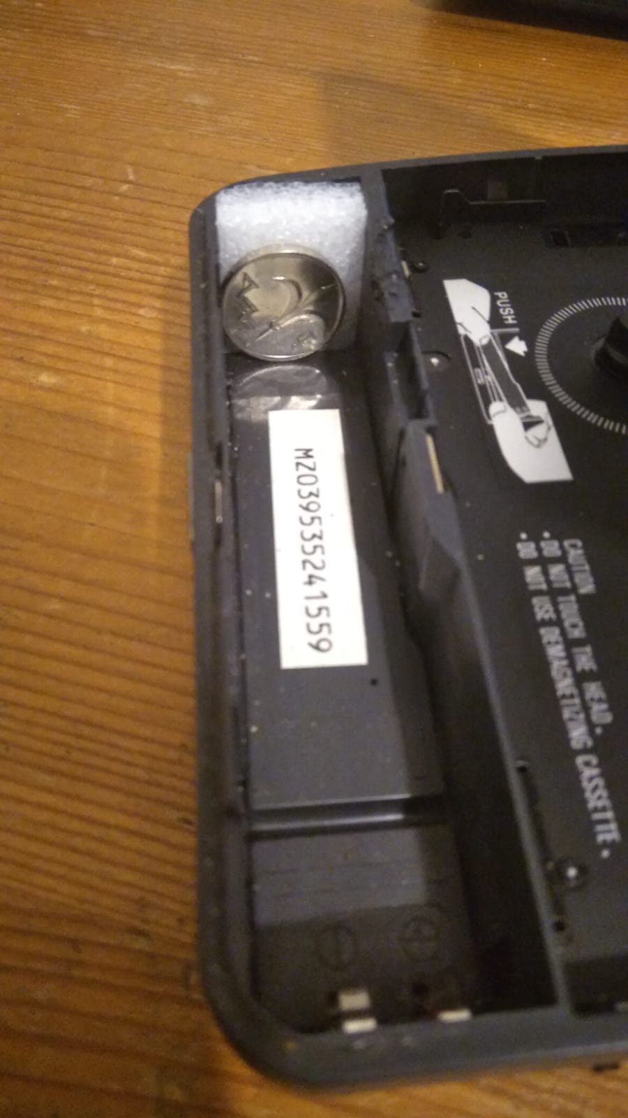

4 AAA rechargeable and interchangeable batteries solution for philips dcc 170 potrable recorder
After week of testing - Works fine.
Jogging-proof.

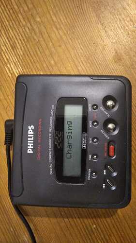

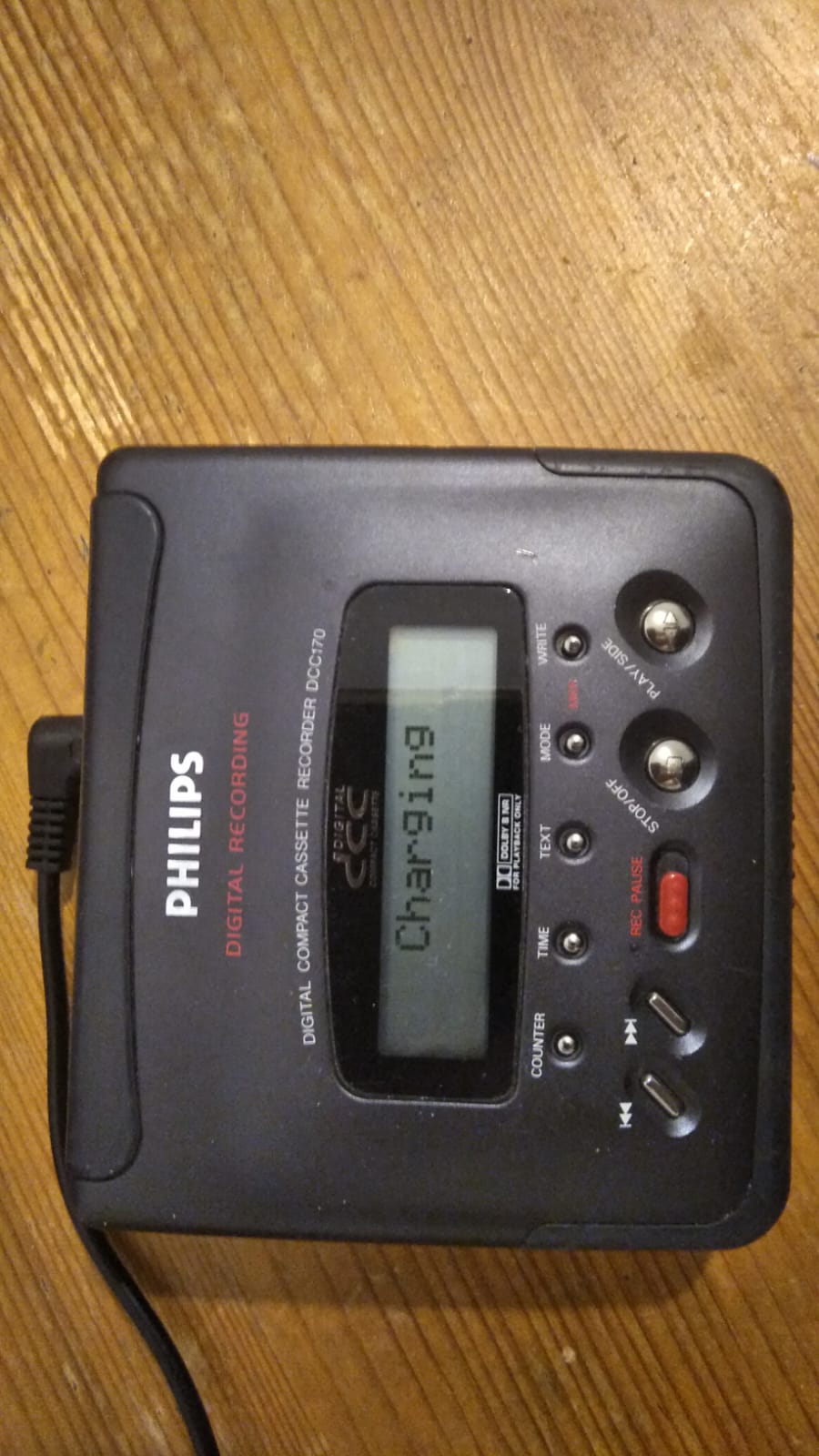

The dcc 170 recharges all 4 AAA batteries inside.
The batteries are completely interchangeable.
Amazingly creative!

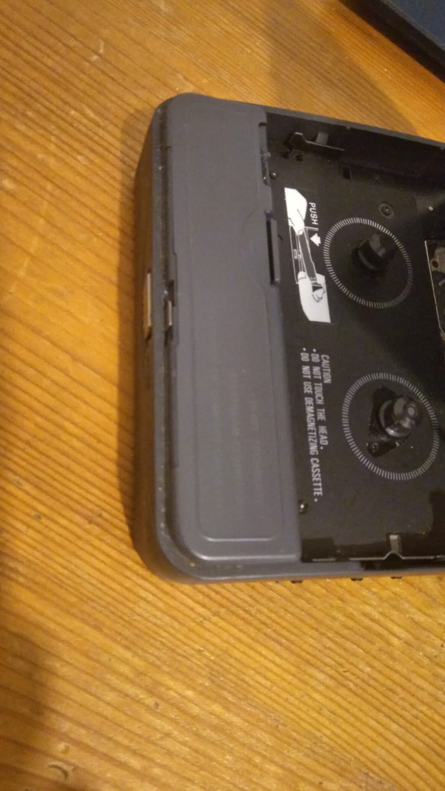

Have tried to reproduce this famous idea and in theory this works. In reality however most AAA batteries are a little to big in diameter so they squeeze the wall plastics apart and you can no longer close the player properly.
Solution would be to sand or dremel the inner wall a bit but I don,t want to do so .
So maybe it works with some batteries but not all..
Bye Michael

Also tryed the topic starter solution and this also works like a charm, a real macgyver solution !
In addition to my former message I have to report that this solution works without case modification but you must use the battery brand as shown in the photos (Ladda by Ikea)
I assume they are a little bit smaller in diameter than others.
Have fun !
Michael
