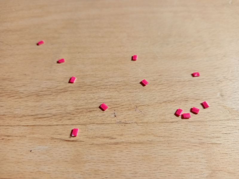

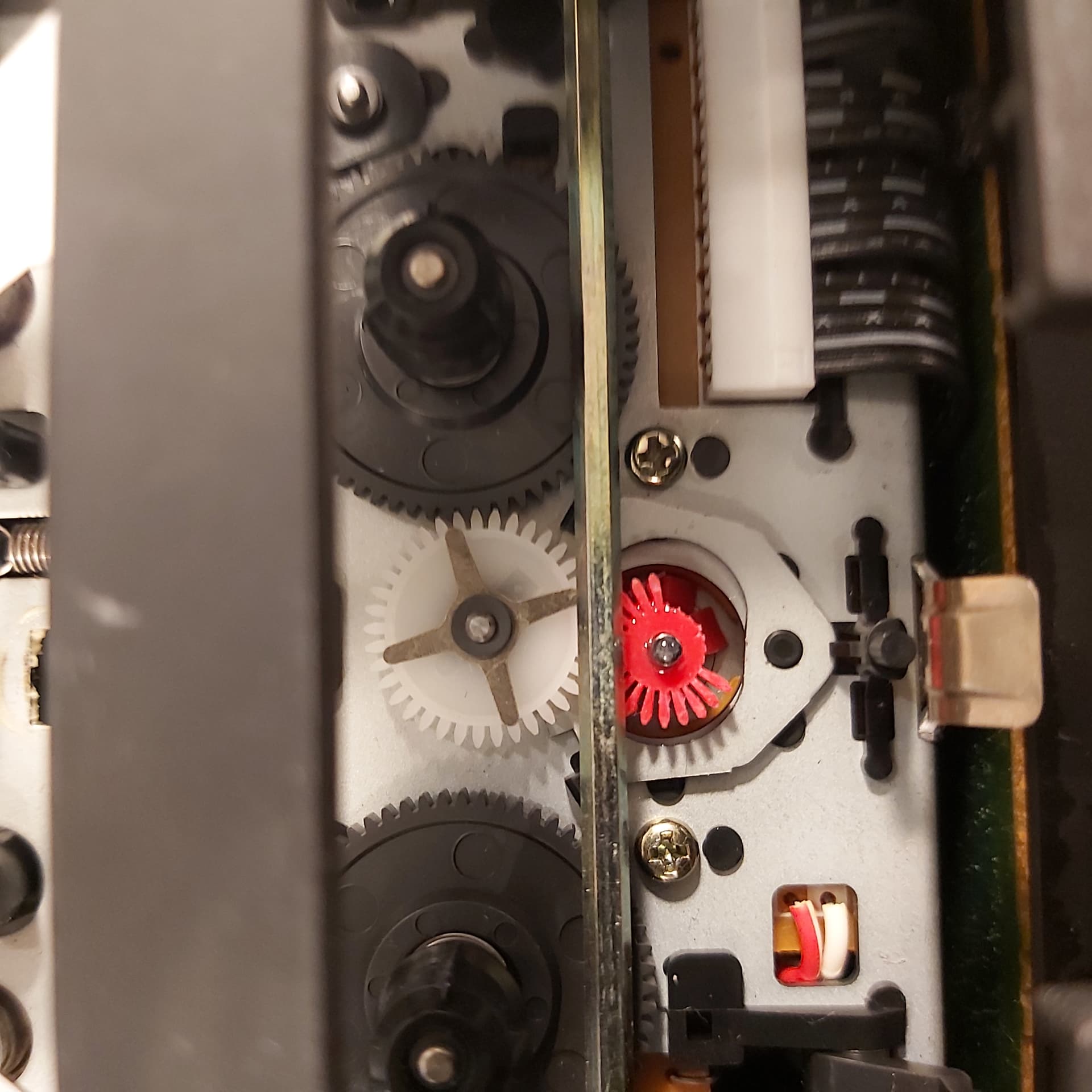

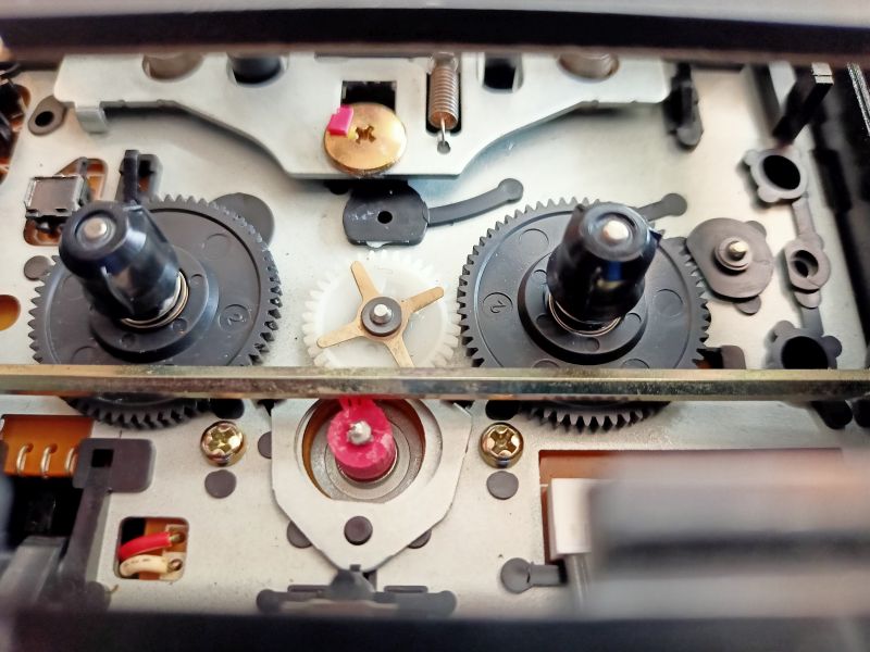

A few years ago I fully restored my DCC 730 (belts, pinch rollers, DCC Museum replacement gear, etc..). So the device functioned fine for a few years (expect for one time I needed to fix gear again to its motor axis) as it is minimally used to test some new bought tapes only. I am more a collector than listener to DCC tapes playing :). So if I recall it correctly, I bought the replacement gear 2/2,5 years ago. Anyway, last week I wanted to quickly test a few new bought tapes, but during the (turbo speed) winding it made a terrible noise and pieces of gear lay shattered all over inside my DCC 730 :frowning: . Result, an almost teethless gear :slight_smile: and therefore since that moment my DCC hart bleeds … (try to create a dramatic setting here :clown_face:).

Unfortunately my gear from DCCMuseum broke after a very short time and I had to purchase modified parts from oher source. Maybe the hole had a diameter a little too big and that causes a small tumbling after glueing and breaks the tooth (see photos).
Other reason could be the shipment in air cushion envelopes.
When glueing make sure the new gear runs in the vertical middle of the white gear. I used superglue for the modiefied parts.
Up to now it,s running OK
