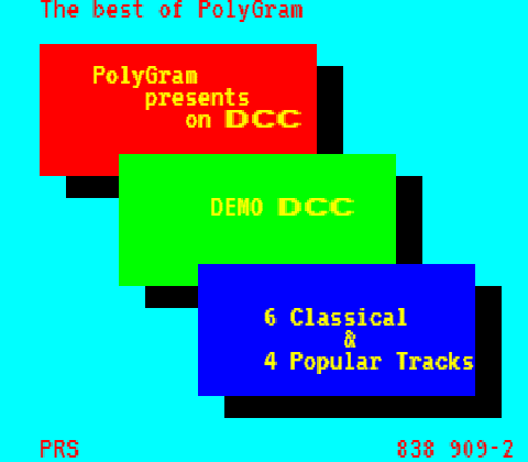

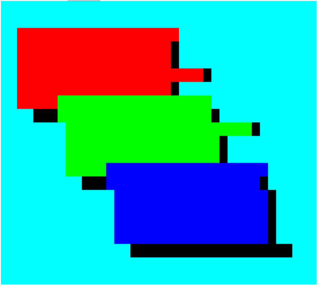

And here is the next iteration. It is pretty recognizable now despite some clearly visible issues of yet unknown cause.
This confirms that I got the character size and the resolution right. The height of the lines is also spot-on.
I think I’ll call it ITTS.js (naming scheme of many JavaScript applications), version 0.0.1 will be released soon for everyone to try in their (modern) browser with buttons like on the ITTS box. The demo pages will look near perfect, which is not always like the ITTS box displays them.

Short technical info: I do not use kaitai.io in ITTS.js. However, it was useful for getting started.
The control and double-width characters do normally count in the position of the text. I expected it and implemented it otherwise. This means it is impossible to let a changed background color start with the first color in it. The control character for the background color will be rendered as a space with that background color. The same goes for the text color at the beginning of a line. That is why we see spaces without text at the start of lines.
The overview and the tracklist of the demo contain empty lines for which I could not find any value to explain this behavior as the 21-line line numbers of the demo do not make any sense.
Thus, it is most likely located somewhere else in the ITTS box code. I will add the empty lines in the overview, as it does look right on the video. However, the tracklist is 20 lines long and fits the four popular tracks, too and the spacing on the rendering of the ITTS box is uneven. Hence I won’t add any lines to it.

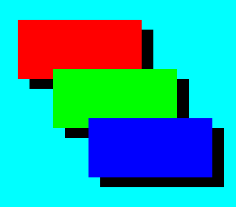

Here is my perfect rendering of the background of the first page. This time it is not as a screenshot but properly saved:

The picture looks promising, on some detail I can’t follow you.
That’s because I’am not familiar with it.
Can’t wait the see the end results.
