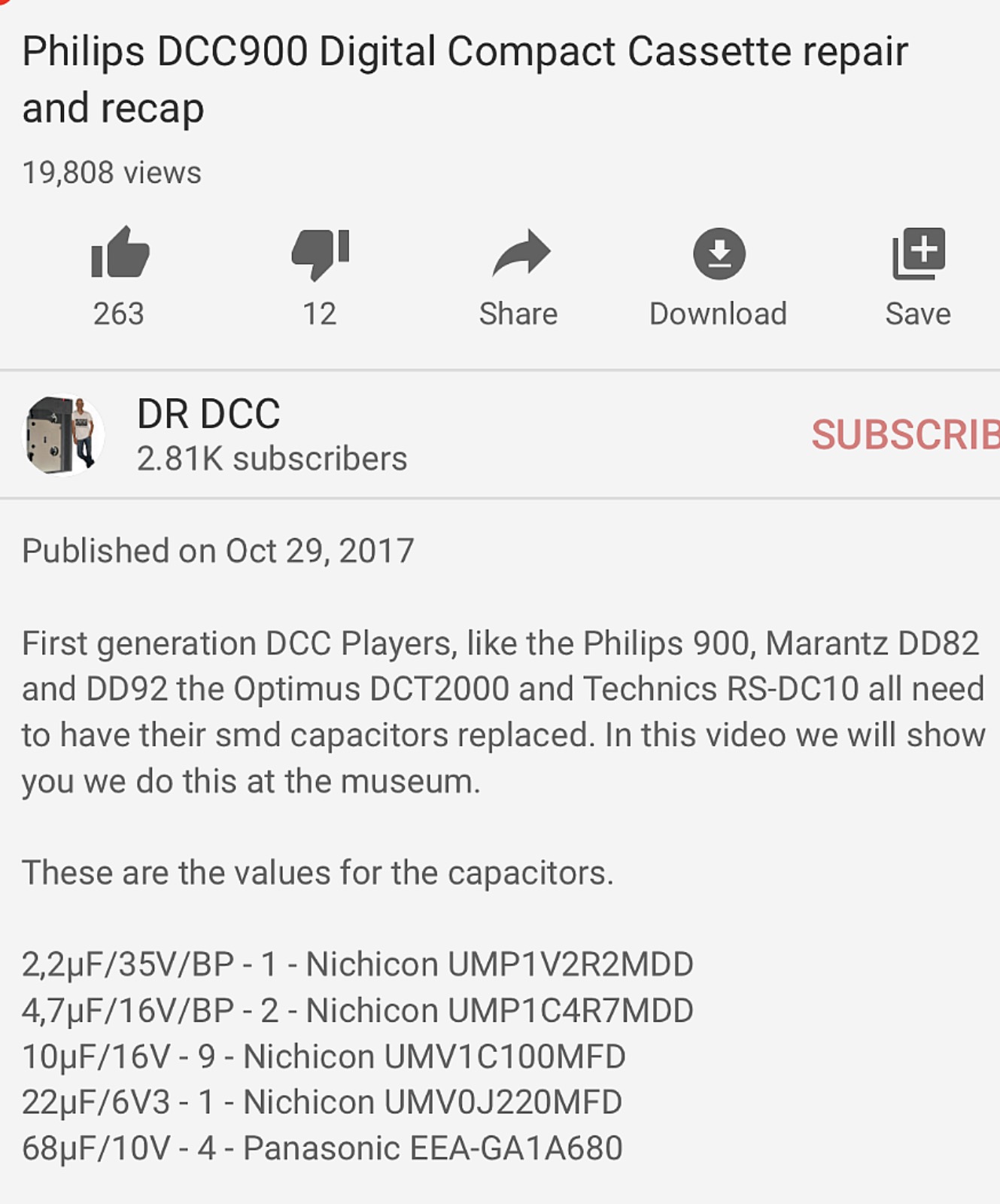

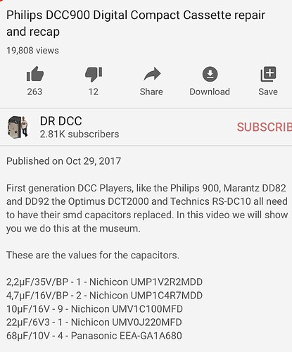

You need to recap both boards. I have attached a screenshot of the Youtube video of the caps to use.
