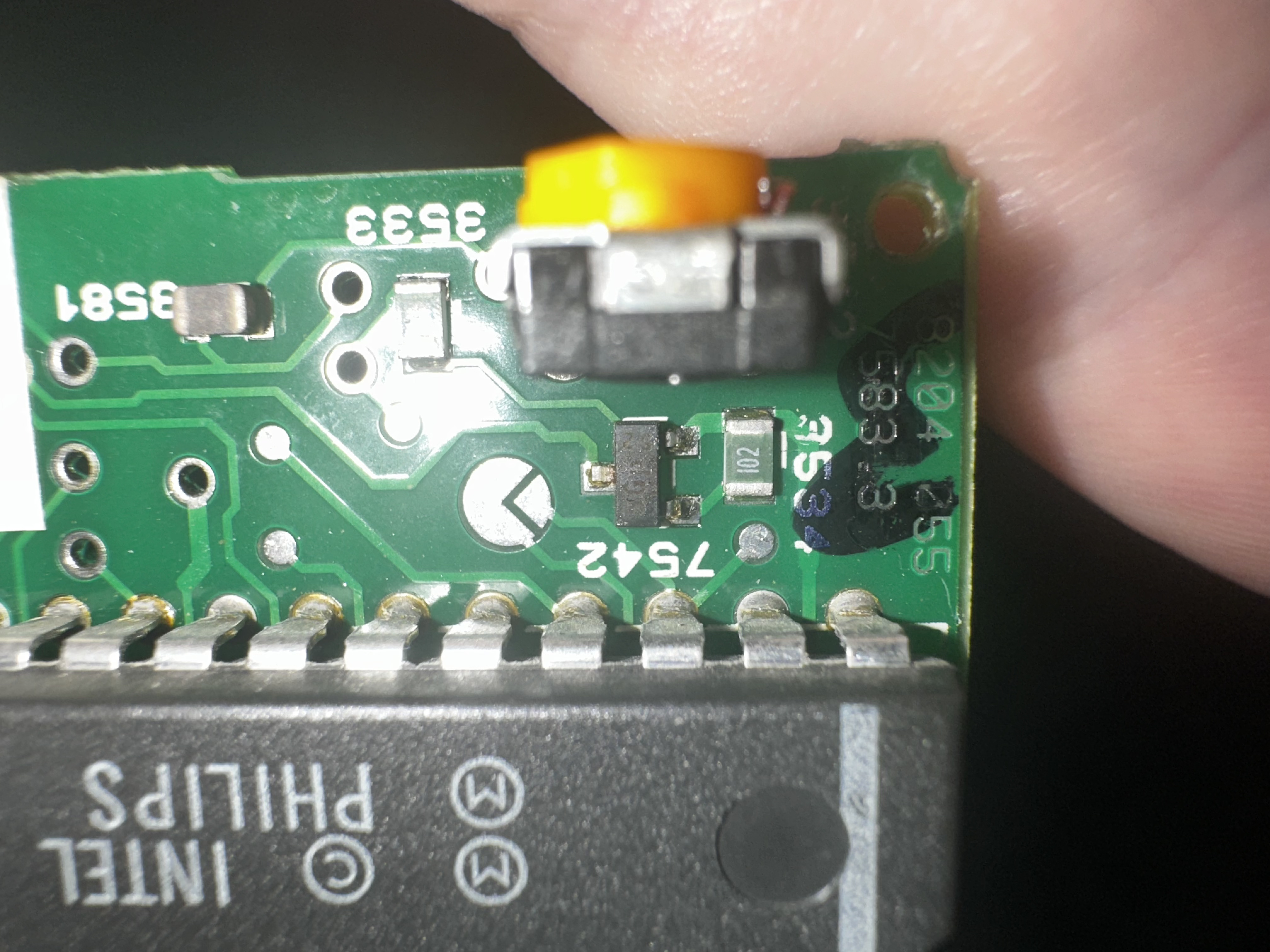

Well, I found something. As the pcb’s of the tape unit are conveniently sandwiched together, I managed to take them apart and have the deck running. On the PCB with the DDC-TDC label, closest to the drive a transistor gets 80c. I think thats the culprit. Hope it didn’t take out that large custom Phillips IC. Happy to have found at least something. Lets see if I can fix it.
This is the culprit: iCloud Photos - Apple iCloud its single top pin is shorted to another pin.
Well, it wasn’t that. I replaced it temporarily with a 3906, does the same thing, but the 3906 doesn’t get hot. I need to start from the main IC (7500) pin 13 I guess.
